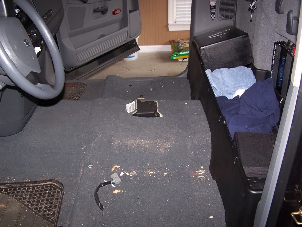

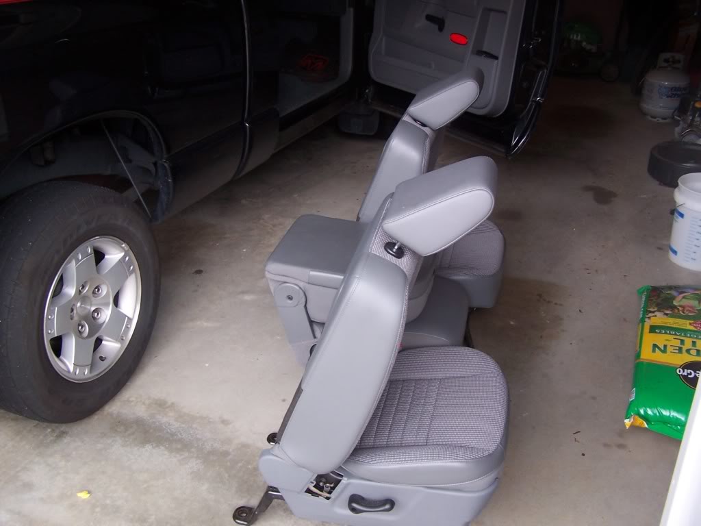

I find it easier to do everything with the seat out.

this is a good time to clean ur carpet well!!

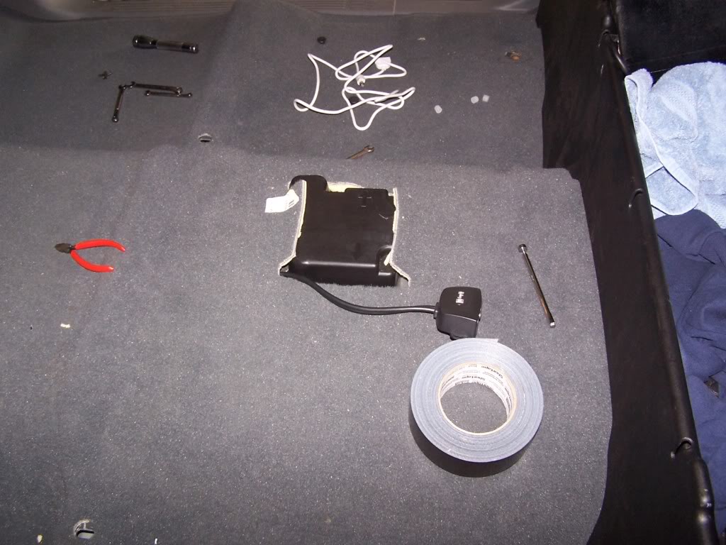

i fished the "iplug box" under the carpet so they will come out under the seat

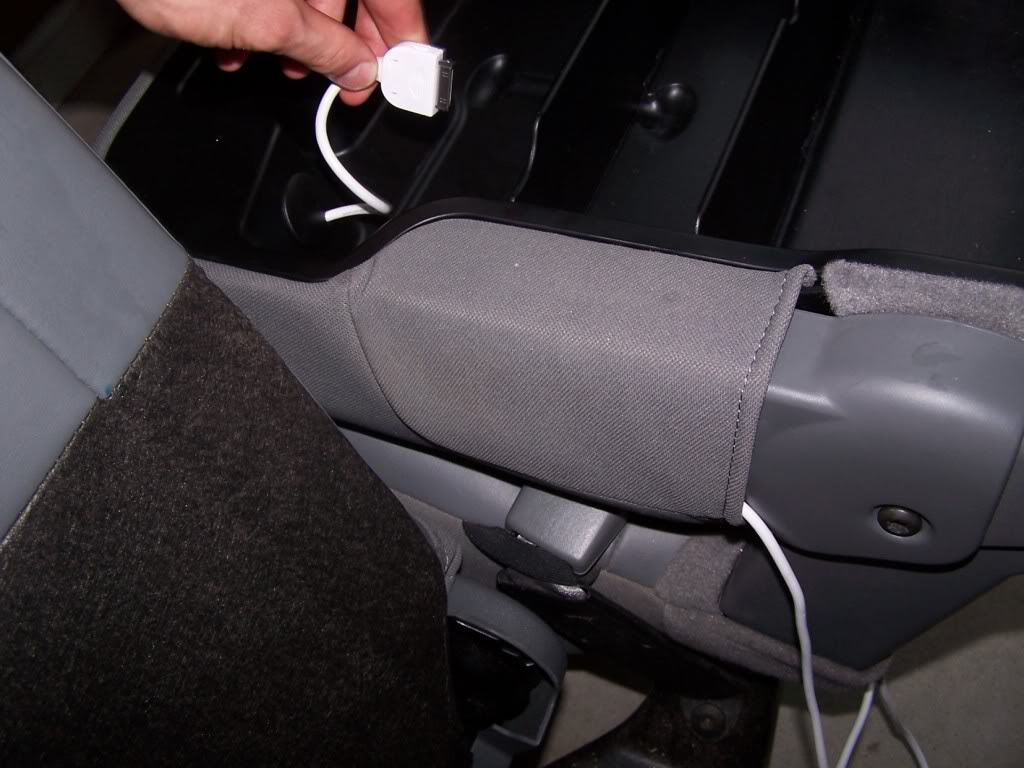

i drilled a hole in the top of a cap that is used for the cig-lighter in the laramie. and fished the cable through it and out the back of the center seat back so you cannot see it

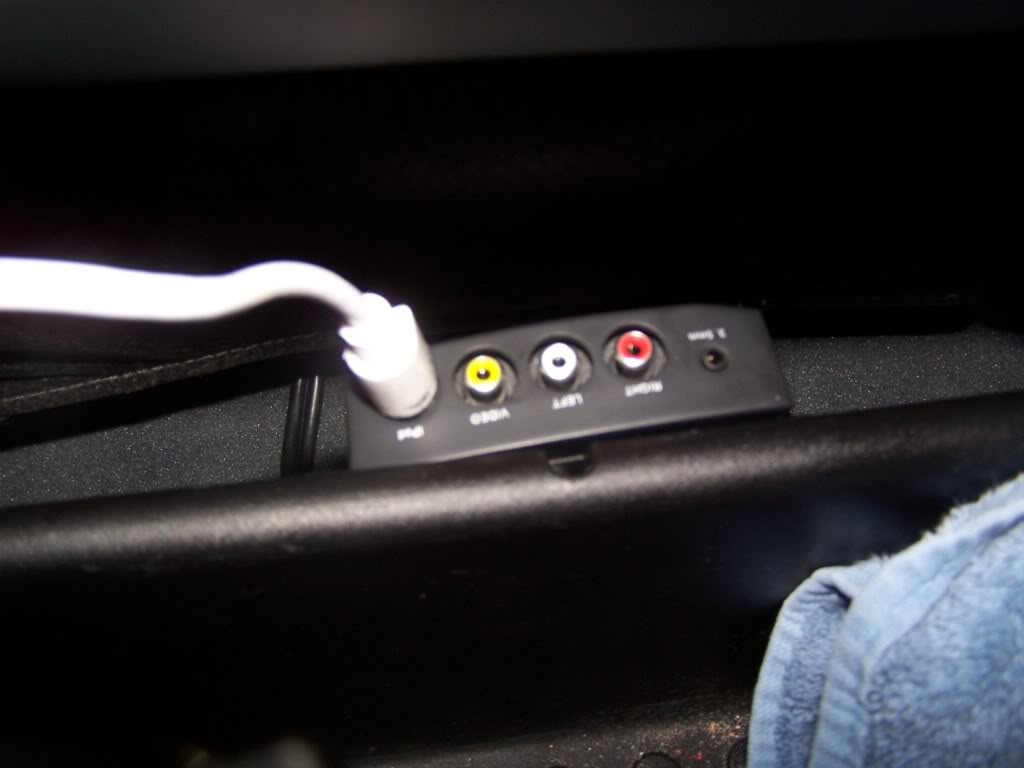

and the "iPlug Box" mounted to the tool bucket behind the seats. alows for aux hookups as well
