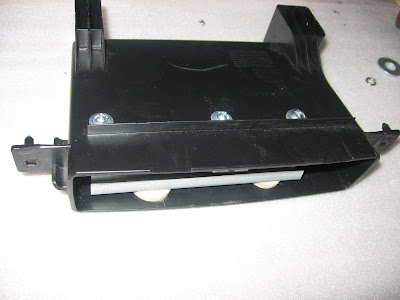

Back to the dashboard at the radio somewhere. The Dodge RAM has an opening underneath the Radio and it appears to be the perfect spot. I removed the dashboard (see Page 8) and got to the 1" by 5" black plastic box that sits right under the radio.

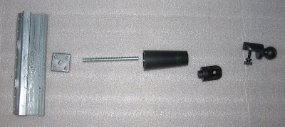

I also had some metal rail from the kitchen remodeling (IKEA) that I mounted inside the box. Note that the square will ride in the rail and I can adjust the lateral position easily and whenever I want. I did cut a thread into the square and the positions is fixed with the screw.
You may also notice the top from the Arkon cup holder ...? I just cut it to length and also did cut a thread in the top two parts. This way they rotate onto the screw.
Here are the parts fixed inside the black box:

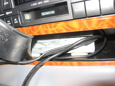

Now putting it all back together. Here is a shot of the parts back under the radio. Notice the rubber mat that is typically in the box. I cut it so it blends the front.

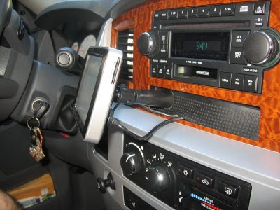

Here with the cradle attached:
I am not happy yet with the rubber mat. I will probably think of something else. But this is all I had available at the point. There are brush openings for computer desks that might work here and allow me to laterally move the holder inside the brush.

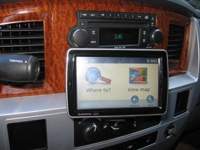

And finally here is the finished product:
I almost exclusively operate my radio from the steering wheel controls. I am not concerned that I do not see the buttons completely.
