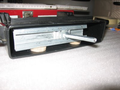

Back to the dashboard at the radio somewhere. The Dodge RAM has an opening underneath the Radio and it appears to be the perfect spot. I removed the dashboard (see Page 8) and got to the 1" by 5" black plastic box that sits right under the radio.

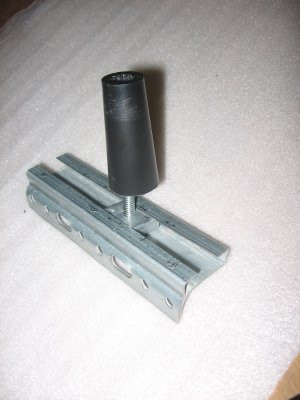

I also had some metal rail from the kitchen remodeling (IKEA) that I mounted inside the box. Note that the square will ride in the rail and I can adjust the lateral position easily and whenever I want. I did cut a thread into the square and the positions is fixed with the screw.
You may also notice the top from the Arkon cup holder ...? I just cut it to length and also did cut a thread in the top two parts. This way they rotate onto the screw.
Here are the parts fixed inside the black box:
