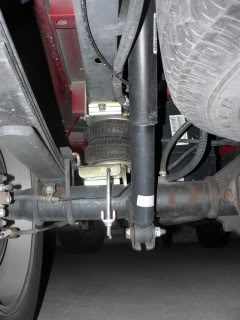

These are the Arnott suspension air bag I have

i just unpacked my bag helpers and i think u bought a not so great kit..... mine doesnt have any drilling required at all, u just remove the bump stop and the bag bolts onto there, and then one u-bolt around the axle, no drilling required. I think this kit is alot better maybe?
I have the Arnott Airbag system. Paid $225 shipped Mounts exatly where you stated. No drilling involved and some HD hardware. 5K lbs bags by Goodyear. However, i cannot use these bags with a lift(I prob. could fab up a block of somesort) Also, it lifted the back of my truck 3/4" from stock even with running the minimum 5lbs of pressure. At 40lbs my *** end jumps up about 1" more. 40lbs held all of about 1200lbs of Oak logs that I put in my bed with no problems.
Easy on, easy off, only problem is you cannot use them with a lift kit. I checked into it before buying my Air Lifts. Because of the way the the Air Lifts mount (I welded mine instead of drilling btw), you can still install either a suspension or body lift, or both...
Your kit is fine, just as long as you don't plan on a lift...
