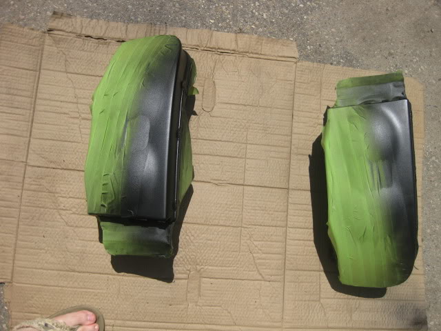

I only painted the outside of my light and no light comes through at night. I did like 3-4 coats of krylon on the outside, then 3 coats of clearcoat on top of that, Do not take the tape off and clearcoat the whole headlight, just the part you painted. I then let it dry for an hour and a half before even attempting to remove the tap so that way i knew for sure it wouldnt peel when i took the tape off. Make sure you buy the superfine line tape, it'll say on the 3m tape what kind of lines you get, i think mine was green and it may have said #3 on it. With the krylon i think i waited maybe 10-15 minutes in between coats before putting on another one, and same thing with the clear coat. Get #3 wetordry sand paper, it should say clear coating on it, and scuff the light when you have it taped off like this..
and then again just very lightly before you clearcoat it.

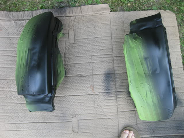

Apply coats and make sure that you put it on very lightly so it doesnt run at first, overlap the lights do not start or stop spraying on the light, start and then go over it and then stop once you've completely cleared the light.
Then apply your clearcoat til it looks as shiny as you want it

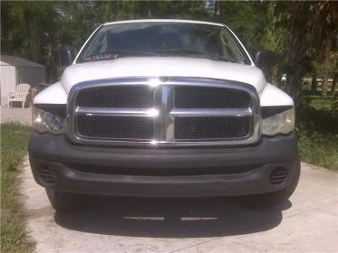

well i did it tell me what you think

Nice maverick, I woulda painted them white to match your truck but at night, can't tell the difference anyways.
