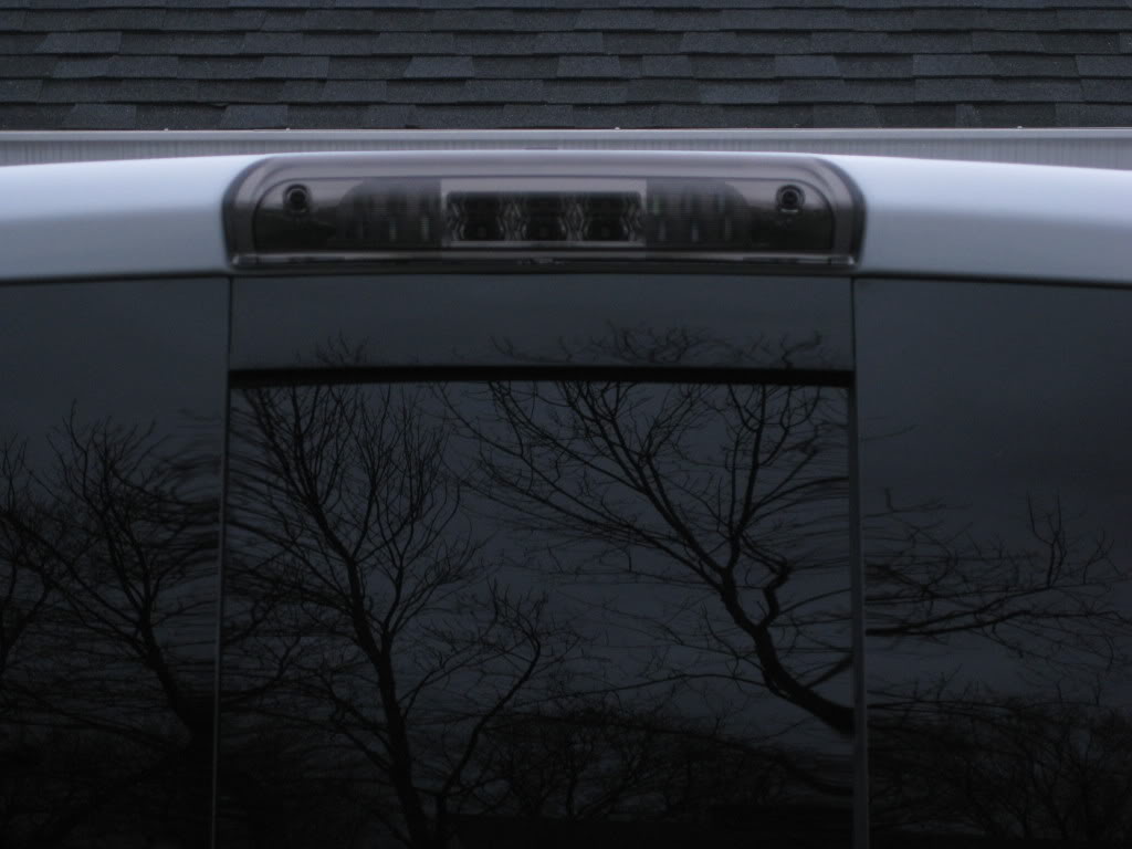

I changed mine. just give it a good pull. maybe put a screw driver behind it to give it a good push. dont scratch the the paint.
