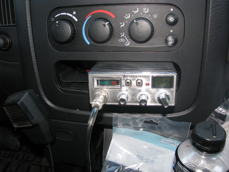

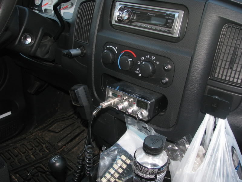

Just threw it together real quick. Using velcro in that slot to keep everything intact and not flying out. You'll need to cut a big hole or completely hollow out the back of that slot in order for the CB to sit in there good because of the antenna cable.

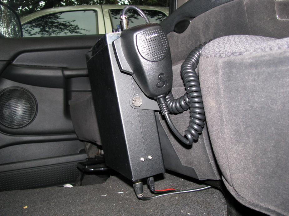

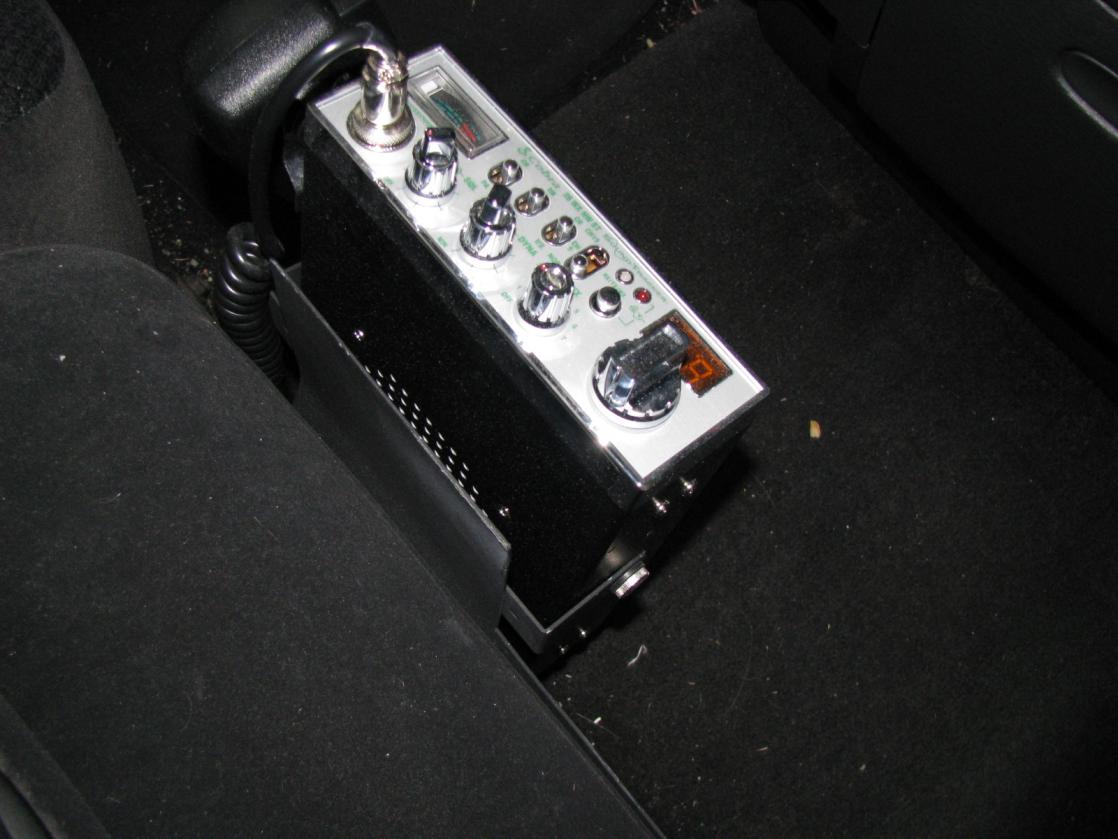

Here are some pics of the mount I custom built for it. It mounts to the center seat mounting bolts.

Originally Posted by soundwavesram
I had one in my truck but took it out due to lack of use.
hmm, i like this idea. the only problem i see is that my seat is pretty close to the cupholder, so i dunno if i could fit one without having to adjust my seat back farther, guess it's a small price to pay though. do you have pictures of the bracket you made?

Not right now, I can look through my tool box to see if I have the mount still, and grab some pics for you.... Heres the link that I based the mount off of though... http://www.genosgarage.com/prodinfo....CB_MOUNT_0305N
But for mine, I put the narrow part closer to the driver side, and I just welded the mount that came with the radio to the peice that I made.
