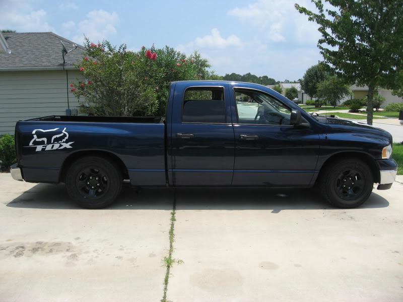

i painted mine. all i did was mask off the tire by taking blue tape, tearing a piece about 5 to 6 inches long, sliding it in between the rims outer lip and the bead. go all the way around, then cover the rest of the tire with newspaper or just tape. then primer and paint. i used engine enamel spray paint. you can get it from any auto parts store and it comes in a boat load of colors. Name:  IMG_1889.jpg

i taped mine with masking tape, sanded, primered, painted and clear coated. I have the crappy plastic covers, and the paint wont last as long as on a regular rim. But it buys me sometime time to save some money for the rims and tires I want. good luck
