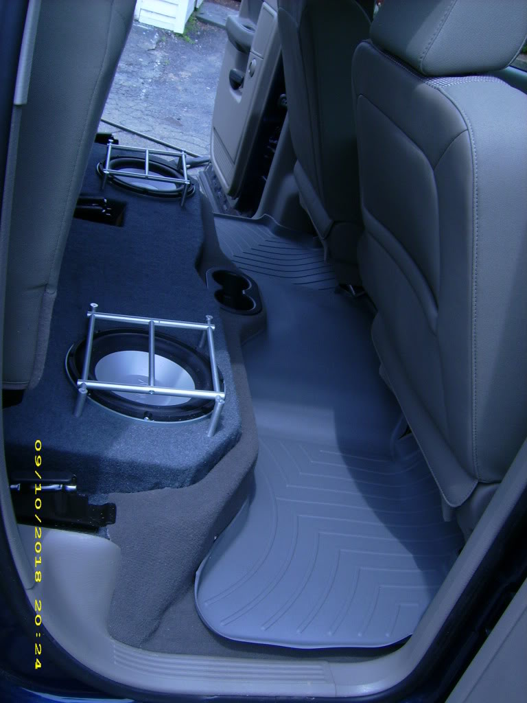

You don't have the clearance to put anything larger in the doors than what comes stock in them. The glass is super close to the speakers as is. I've got 2-10's under the back seat. problem with pre-fab enslosures is that you cannot put large magnet subs in them because they don't have enough depth clearance so that leaves out a number of "better" subs to go in them. So, I built my own.
I went with MBQuart DB series for the 6.5's and 6x9's in the doors. I have a JBL GTO75.4 channel amp running those and a JBL/Crown BP1100.1 running th 10" Infinity Perfects. The sound is awesome. I'm running a Pioneer Avic-fb90t indash unit. Amps are under the seats.(just enough room....you can see the floormat mold lifting up as it goes under the seat because it's riding up the amps..lol)
I also have a batcap capactior, 1/0awg Stinger pro cable and StingerPro Distro blocks along with a few other goodies that are hidden. Highs re crisp, mids are tight and the bass is firm. What more can a guy ask for?

lol this isnt related at all, but you must be livin in the future man, your takin pics from 09/10/2018! lol

thats some nice equipment you have there dirty dog
