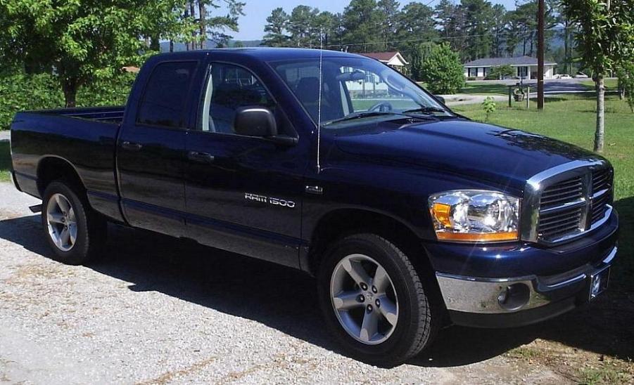

So I could bolt on a nice free flowing exhaust system and get more high end? That would be nice. Would a free flowing intake setup do any good or is the stock system as good as any?
Here's a pic of my Ram...if it worked right.

Let's try that again...
