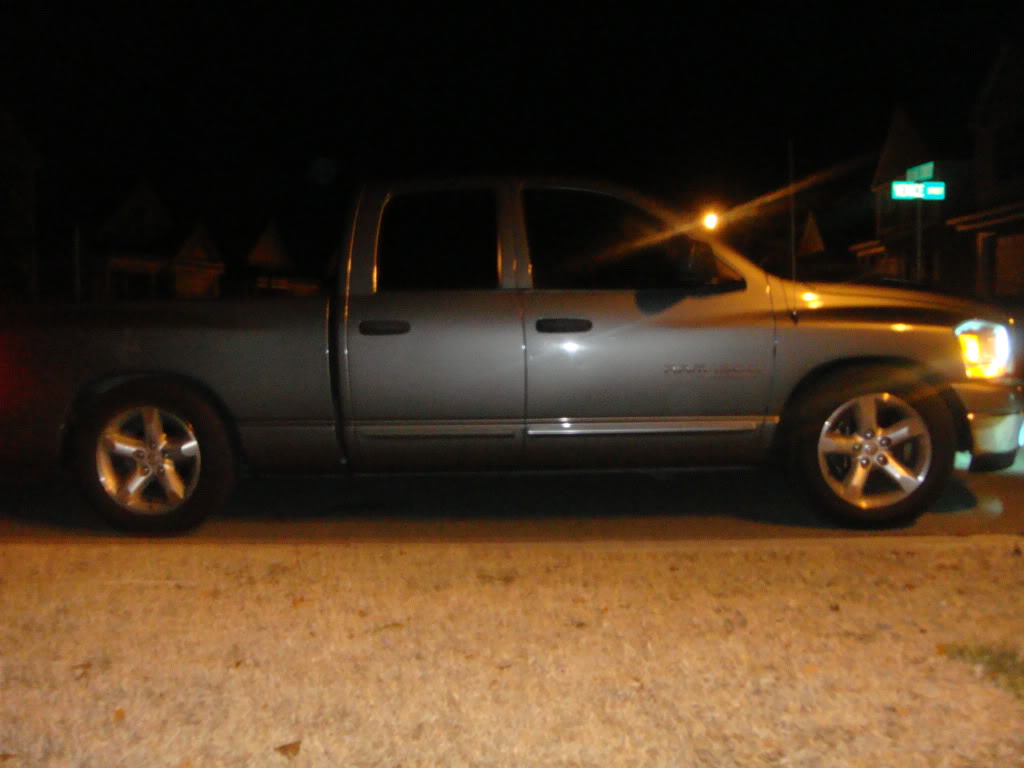

sup all,
I just finished my truck this weekend and will post some pics tomorrow. I have not been on in a while so had to read the past threads...saw there were some questions about a 4/6 drop and C-notching. I originally put a Mcgaughey's 2/4.5 drop kit (coils up front) with belltech nitro drop 2's. I left the stock shackles on/welded the perches on the axle...I like the way the rear sat so I ordered 2" drop spindles from Mcgaughey's, I now have a 4/6 drop and no C-notch. I had to learn how to drive the truck again, I learned were all the pot holes are...lol. I do crawl over speed bumps but it's not because of th e frame hitting. the ride is great 110% better...no body roll when taking corners.

well here it is...sorry about the crappy pic will take one tomorrow once it is washed if I am not working.
