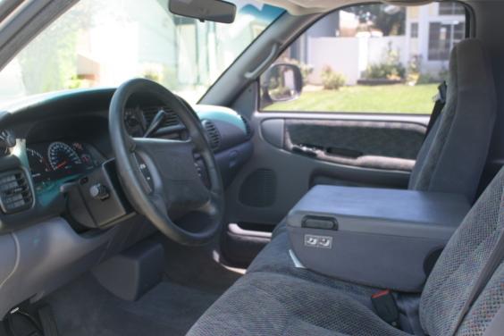

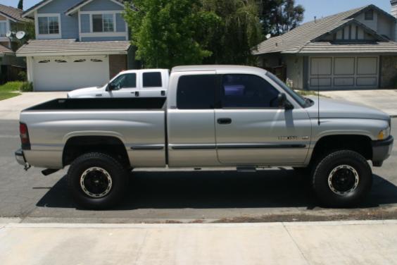

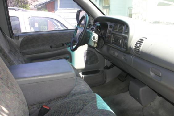

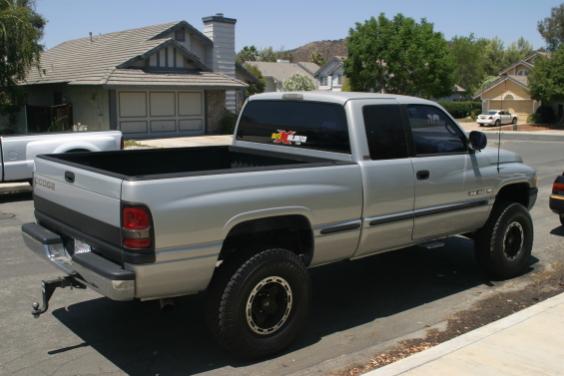

Thanks Laramie1997, Went and paid for and picked up the 98' just this morning before reading your post...... 103,256 on the clock, seems to run good it was a 68 mile ride home all highway wasted about 1/8 of a tank according to the I think optomistic fuel gauge...LOL. My sister said she could see the front wheels moving a bit on the freeway from side to side...as to be expected since the play at the wheel is about 4 in. going to my local alignment shop on monday. also when parked I can move the front tires about 1/2 an inch with my hands, The front end is my main concern....
Laramie1997 what are some of the symptoms of the plenum gasket failing??
Tranny seems to be o.k. we'll see how it holds up...
Here's some pics
Has a Fabtech 6 1/2 in lift
Procomp 35 inch tires and 17 in. Procomp wheels almost new including a spare Procomp wheel and a brand new Procomp tire sticker still on it.
Proline sprayin bed liner
Flowmaster
and the little side steps drop down when you open the door and fold back up when the door is shut electronicly not sure on the brand.
One ding on the driver side door is about the only noticible blem and the front bumper looks like it gently kissed a pole just above the front plate..
Othe than that its clean and straight the guy bought it new i'm the second owner..
