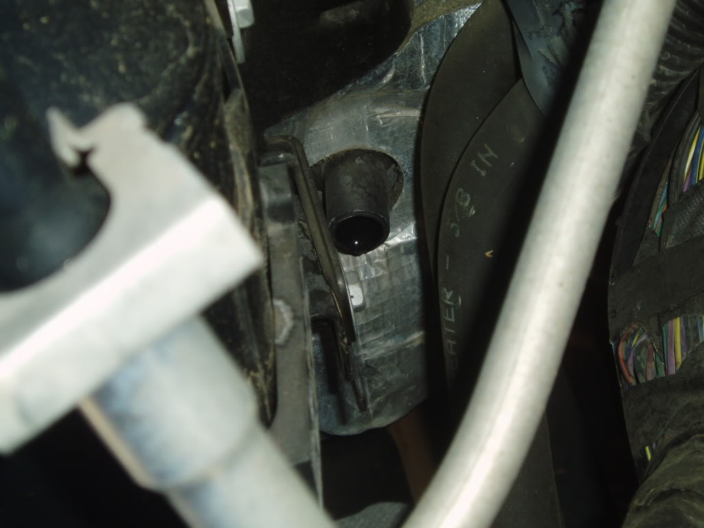

alright well ill look at it when the truck cools off its too hot to doing anything. another question what is this
that black plug with nothing on it.
Old Aug 5, 2009 | 01:25 PM
ramhunter9's Avatar
ramhunter9
Joined: Jun 2008
Posts: 5,343
overflow of some sort do you have to much fluid in her?????
Old Aug 5, 2009 | 01:27 PM
SilverBullet08's Avatar
SilverBullet08
Posts: 6,556
From: TX
ok yea bc thats is dripping fluid now too. idk i havent done anything besides the rear diff...
Old Aug 5, 2009 | 01:31 PM
ramhunter9's Avatar
ramhunter9
Joined: Jun 2008
Posts: 5,343
you got probs young jeti do what i do just use the force man!
