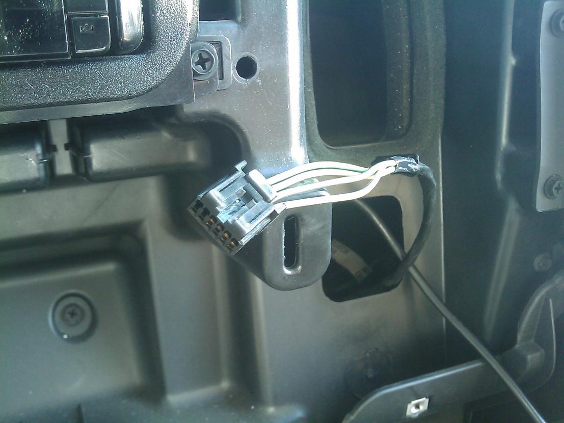

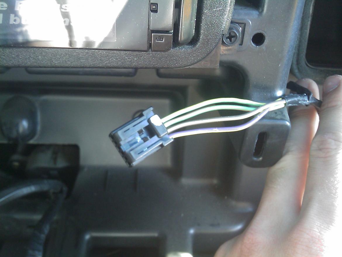

I have a 2002 Ram, just installed a aftermarket radio and seen a wiring set that just plugs in to a place holder. I am curious to know what these wires might be for.
The colors are:
Purple/Yellow
Gray/Yellow
Green/Brown
Green/Yellow

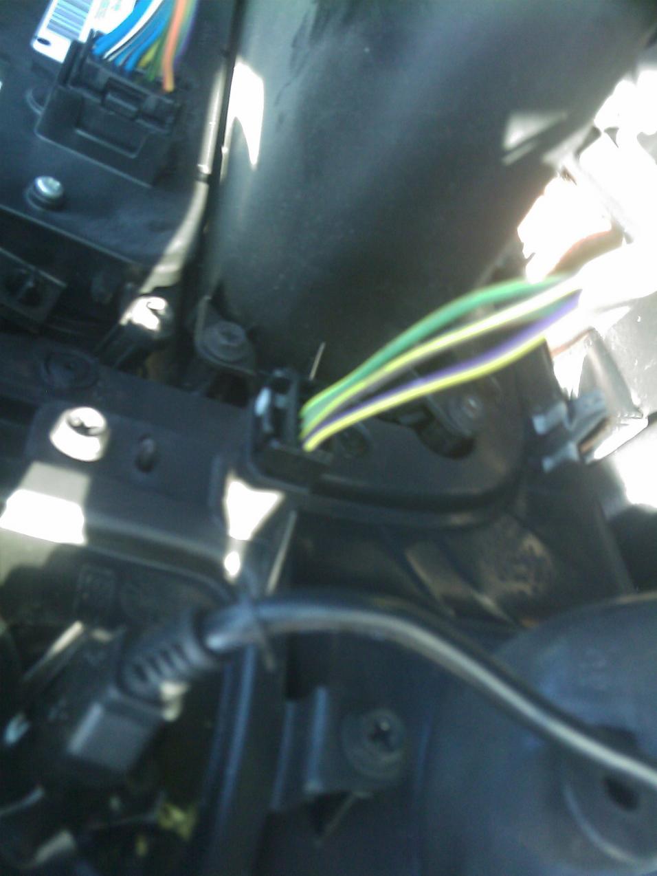

The harness is located on the right hand side behind the center console, in the same location were the cigarette lighter is on the left side.

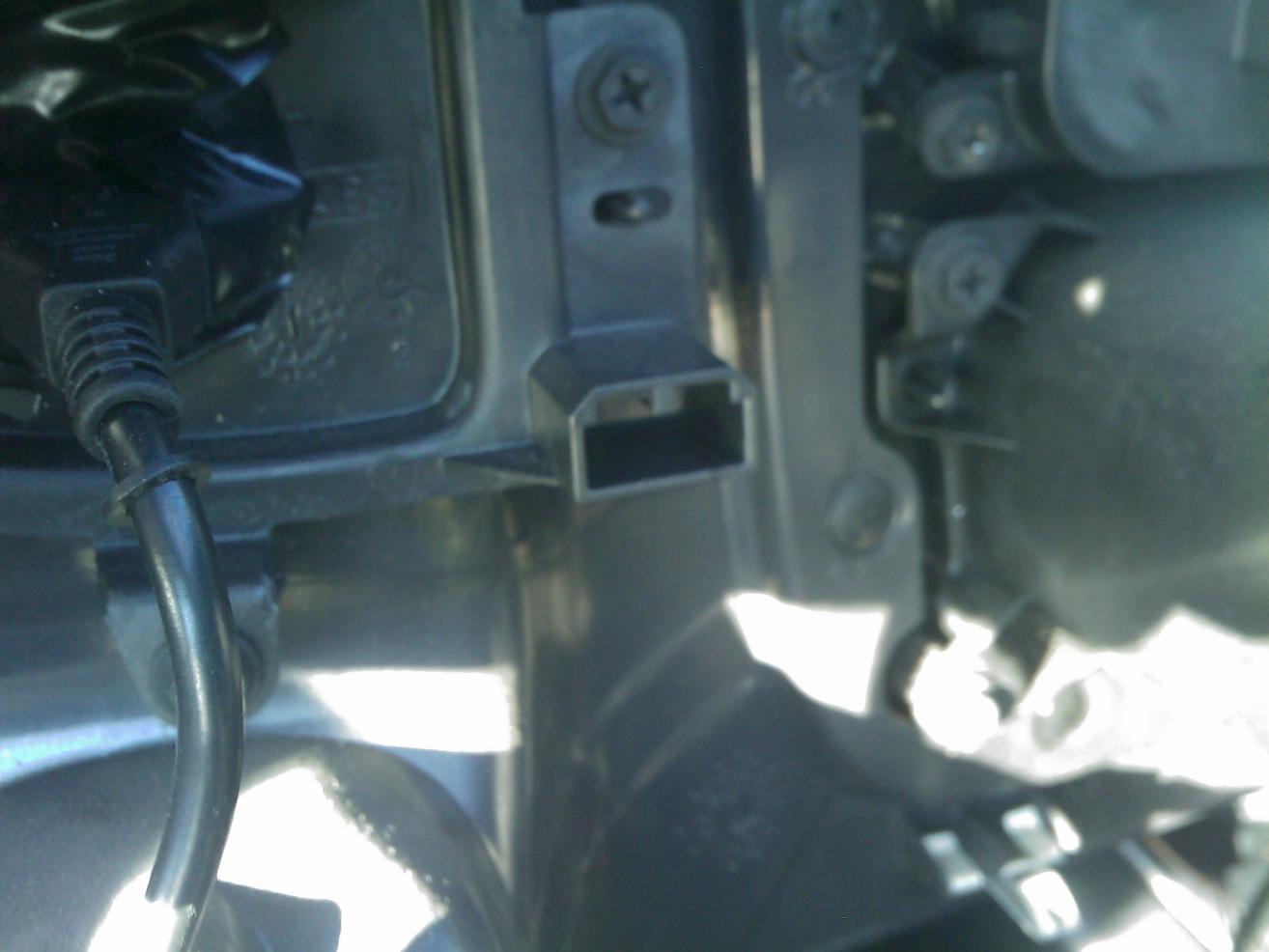

the last two pictures show were the harness plugs in to, which is just a place holder.
Thanks for any help.

Is it in the panel you removed to get to the radio? My guess, it's the connector for the dual-zone climate control. My '03 has it, too. Sorry, didn't read all your post, blame it on Jim Beam.

Does it have power going to it? My be for an aftermarket auxillary power outlet
yea it is right behind the panel on the right hand side. damn Jim Beam!! lol
I nerve tough to check, duh! I will have to do that in a little bit.

Does it have power going to it? I just checked and the Green/Yellow and Gray/Yellow both have power. the other two Purple/Yellow and Green/Brown do not.

did u check the owners manual? maybe it says something about it. Also you could start pulling fuses one at a time to see when the power goes away and see what it says it is.

OK, I think I found out what the option was, the Passenger Air Bag On/Off Switch. I was looking around and found a picture on this page: https://dodgeforum.com/forum/3rd-gen...d-gen-ram.html and in the like the 10th pic down you can see what it looks like. Thanks for your guys help.
