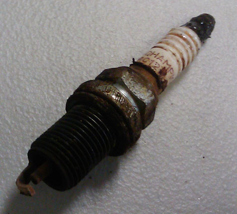

Okay, so i pulled all the plugs out to see what side the gasket might be blown on. On the drivers side, two front cylenders are full of antifreeze.
Looks like i can avoid a head gasket change on the passenger's side... for now!

Welp, here is a shot of the spark plug. The insulator was completely gone and the threads were covered in gunk. It was pretty obvious which head gasket i would be changing at that point.
Also attached is a shot of the head gasket. Never seen a blown head gasket before... i guess a little bit of failure makes a big mess.
Thanks for the top Horseapples. Yes the fella got Felpro gaskets but no copper coat. Unfortunately the head has been torqued back on and the chain re-attached to the cam.
