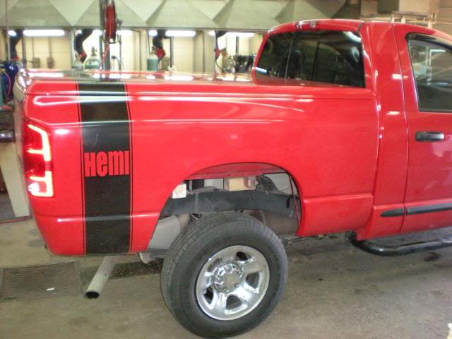

Just remove the four bolts, lift bed 3-4 inches, and it should just lift/slide out. I didn't even bother taking the bumper off. I just pulled it all out as one piece.
