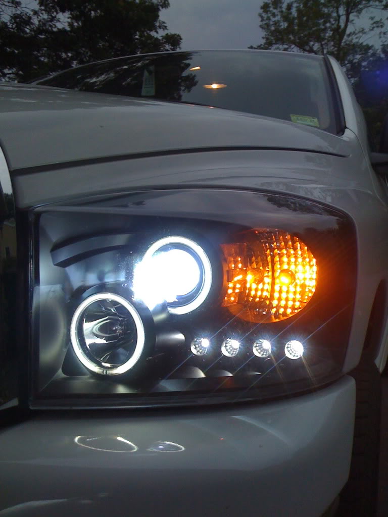

I have 8000k in my projector headlights with the halo rings. I love them and they don't blind people.
