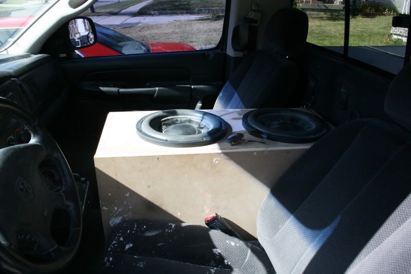

This box isnt finished still needs carpet but what about the idea of a pair of twelves instead of a center seat :P
This is 3.5Cubes tuned at 29hz with the port firing toward the front cup holders.. Two x Adire Audio Brahma MK2's with two Elemental Designs NiNe.1 Amplifiers strapped at 2ohms
I have the NiNe.1's behind passanger seat
Have my Audison 4 channel under the sub box
And second battery behind driver seat..
Pounds real hard
it must be weird watching the subs while listening to music

The subs are in a common shared chamber of 3.5CuFt
Its a lil weird I guess watching them while the music plays but at the same time kinda cool to have them wanging away while you cruise, same time everything isd moving and vibrating not just the speakers :P ,, only downside is passanger is hard to comunicate with eheheh
Pounds real hard
haha yeah that box would be way to much for me.. it looks like it would be an uncomfortable ride as well

If you go with the center console idea like mine and use tens ported instead of 12's you can get away with a much lower and smaller box .. around 2.1CuFt around 31Hz would be perfect..
Its a lil uncomfortable but im gonna make it 1inch shorter height and 2 inches longer when i rebuild the final one.. ive tried out 3 boxes so far to see how I like the sizes and tuning...
