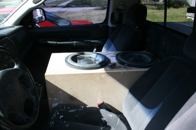

02Regcab's Avatar
02Regcab
Posts: 235
From: Acton,Ontario
This box isnt finished still needs carpet but what about the idea of a pair of twelves instead of a center seat :P
This is 3.5Cubes tuned at 29hz with the port firing toward the front cup holders.. Two x Adire Audio Brahma MK2's with two Elemental Designs NiNe.1 Amplifiers strapped at 2ohms
I have the NiNe.1's behind passanger seat
Have my Audison 4 channel under the sub box
And second battery behind driver seat..
Pounds real hard
Old Sep 25, 2009 | 08:02 PM
kx250frider617's Avatar
kx250frider617
Posts: 1,562
I bet, but i needed the extra seats and wanted the enclosure to be stealthy. does each sub have its own chamber or is its just one?
