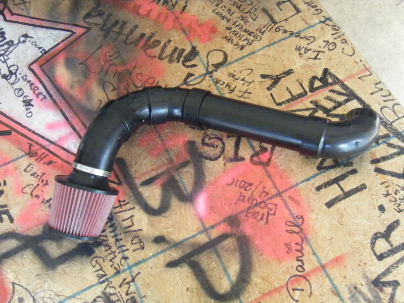

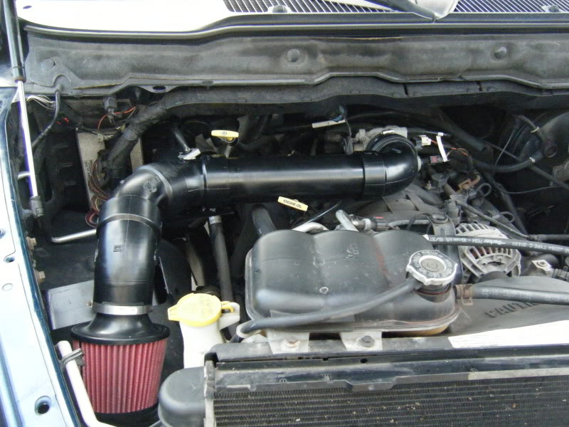

so i took a look at your guy's intakes and i cut mine up a bit more. how bout this? and yes, it is a trash can haha

i used the factory connector boot that was attaches the TB to the resonator box. i changed it up a bit since then and this is what im runnin now. to get exactly what i have you'll need (3) 3'' 45* PVC street bends, (1) 3'' 90* street bend, and a 2' section of 3'' PVC pipe. i just fitted it all together and painted it.

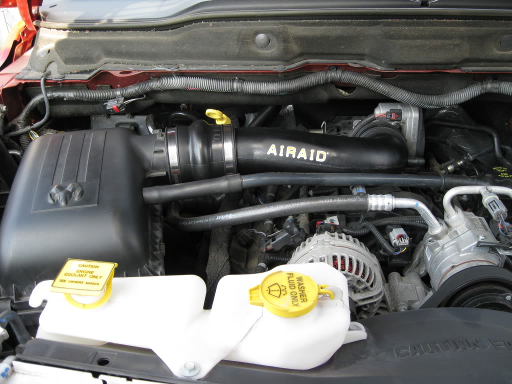

Originally Posted by espinosafell
When I removed the Hemi Hat as we call it and I did not see the connector boot just a rubber piece that is on the TB.... When I used a 3" it did not fit snug it was hanging loose... the Hat just came completely out... A little bit of newb right now... I just want to keep my stock box since I dont want **** to get into my TB... So I wont need the other bends... just want something to go from the TB to the stock box...
You need a Airaid MIT pipe. Takes minutes to install.

i have a 4.7, you have the hemi... hence why you didnt see the rubber connector boot. you can get one from home depot for like 3 bucks.
