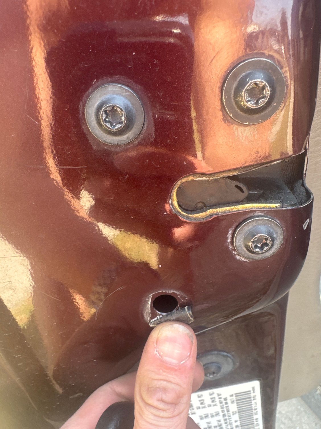

Same thing started happening to me but everytime I’d try to open it from the outside it would lock but I looked in the handy chilton book and there’s an adjustment screw right below the actuator covered by a little sticker
after messing with it loosening it yanking on the handle found a sweet spot to tighten it back down where it wouldn’t lock it works like new no replacing the actuator or anything
