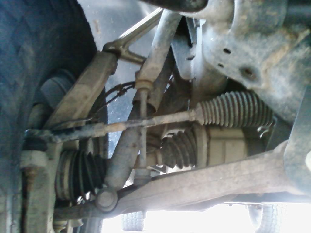

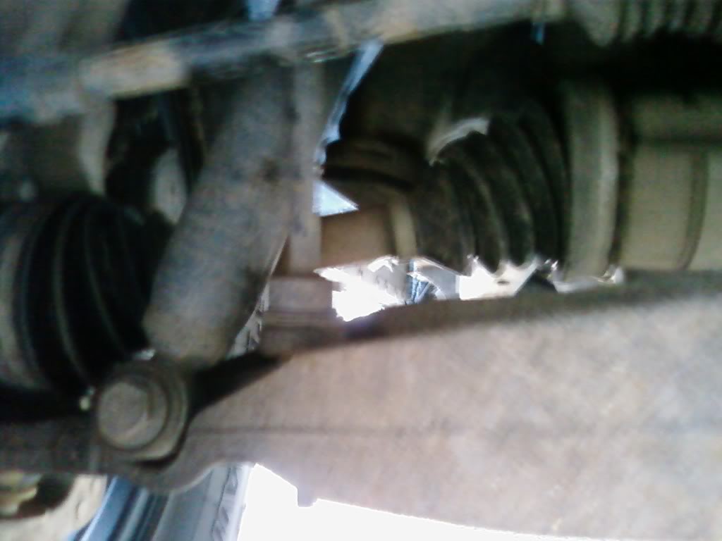

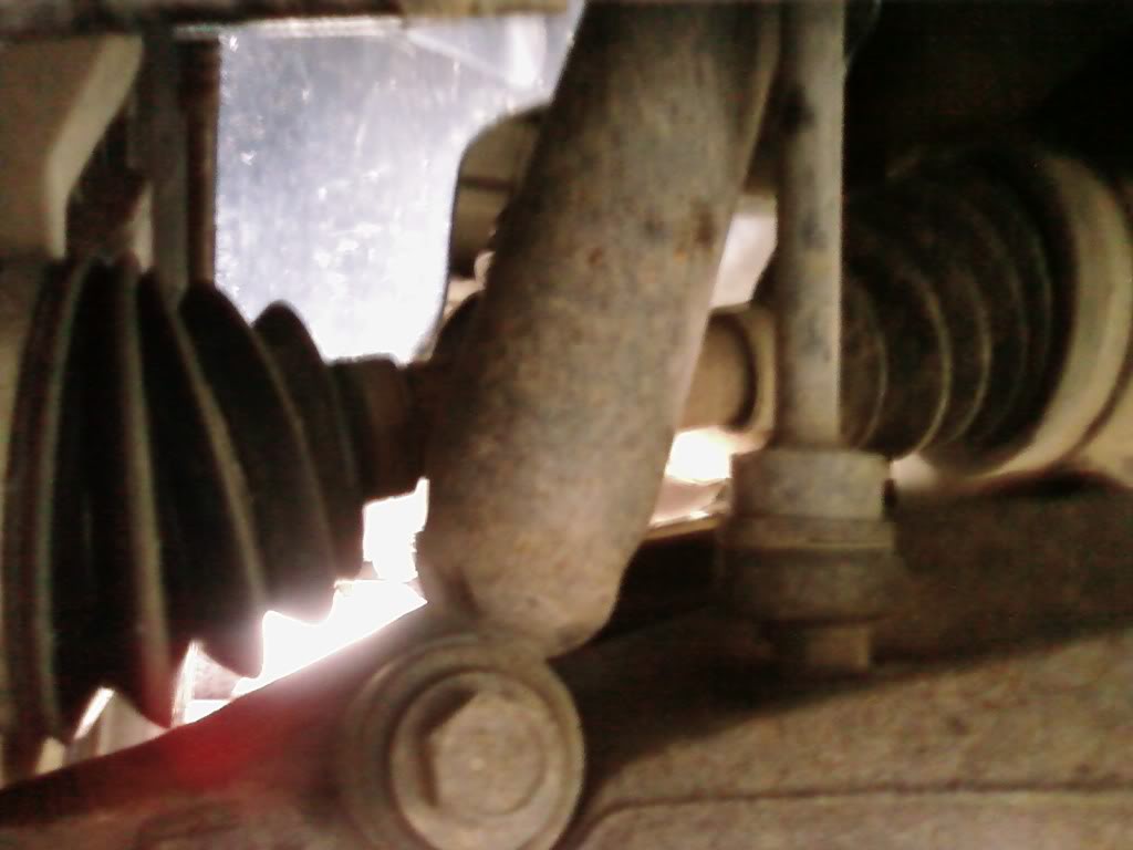

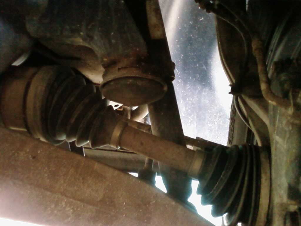

i took some pics... they dont look as extreme as butch's, but still pretty steep to me... what do you guys think?

They don't look that bad and they're definitely not my definition of an "extreme" angle.

def not my def of extreme butch's were extreme....i think you should be ok your planning a b/l soon any way so youl be able to back off em a bit anyway

thats what i was hoping to hear... thanks guys. I will leave them until one goes flying out into the diff, oil pan, and transmission. lol

I've seen a LOT worse. Unless coupled with very large, heavy tires (like 37s and bigger) I don't think you'll have a problem, unless you plan on being featured on an episode of Extreme 4x4.
But it does look like a heck of a lot more than 1.5" higher from end to end. You sure you only went up 1.5" or were they level to start with?
