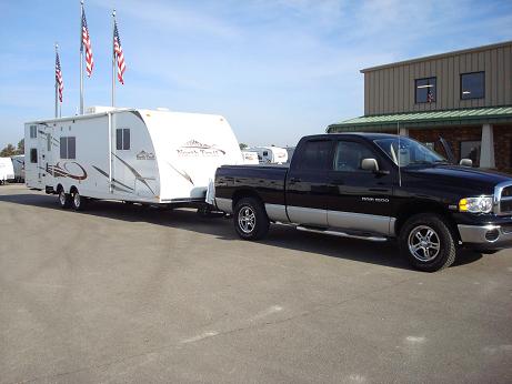

my setup looks just like that equalizer hitch. looking at the picture, the rear looks like it has too much weight on it compared to the front.

trial number 3
It's hard to tell from the picture, but looks like your tongue may be up too high. The trailer frame should be level front-to-back, or just a little low in the front.
