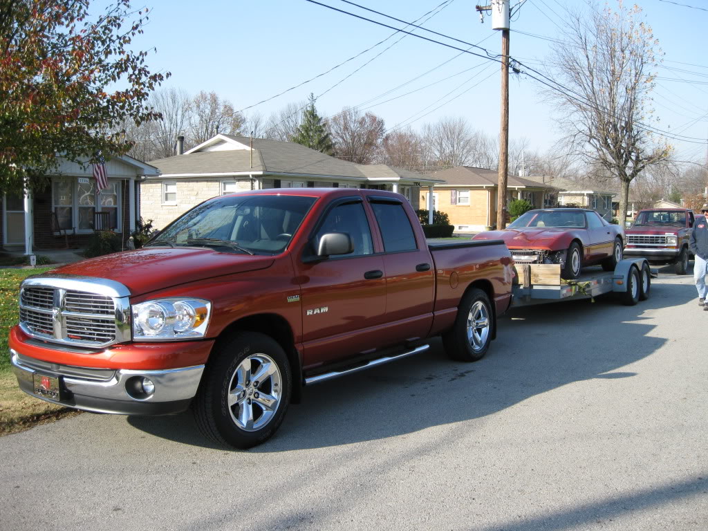

It's a hitch adjustment issue. Mine uses chains. Never had a chainless one before.
I have this one. Makes a huge difference!! http://www.summitracing.com/parts/CHT-17002/
You have to have enough tounge weight to keep the trailer from jacking the rear of the truck around.
Here's my truck with my 2700# trailer and a 84 Vette on board.
