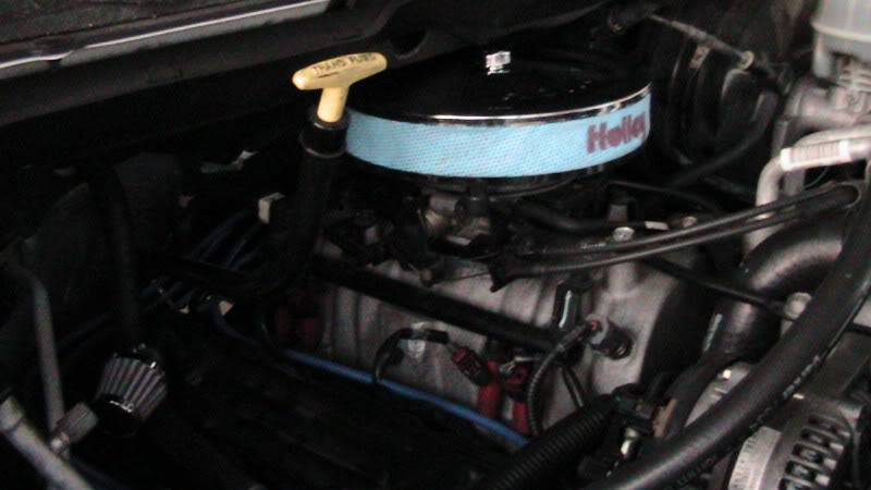

From: fredericktown
Originally Posted by dirtydog
Water up to bug shield = water sucked in through air filter.
Your air filter openeing is at the bottom of your headlight. if water covers your headlight your screwed.
i had my airhat intake on with a riser. no problems ...

dirtydog's Avatar
dirtydog
Moderate User
Posts: 17,003
From: Albany, NY
^^^^cheater....lmao
