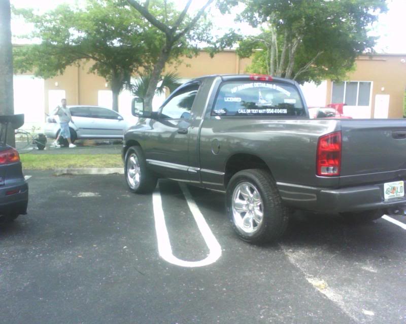

I have the 305/50 on mine and i love them ... Makes the truck look lider ... But they do rub in the front on the sway bar and the frame ... not to bad tho and only when you have it turened to its max both ways.
Old Dec 20, 2009 | 05:34 PM
Got_Hemi44's Avatar
Got_Hemi44
Joined: Nov 2008
Posts: 1,751
From: Dayton, Ohio
Hmm that's weird. Mine don't rub at all even on full turn.

Old Dec 20, 2009 | 07:22 PM
pickup212's Avatar
pickup212
Joined: Oct 2009
Posts: 61
From: Ft Lauderdale
Really?? Thats weird ... Idk why but my truck looks a little lower in the front in out pics ... Maybe my truck sits lower for some ressen causing the running on mine.
