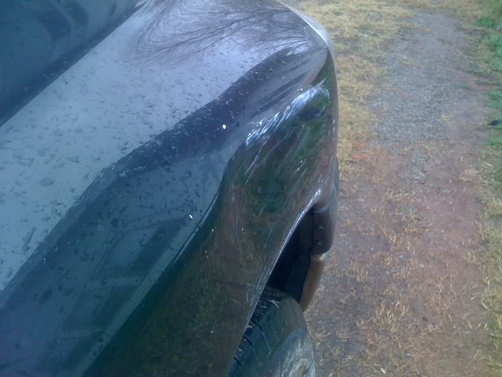

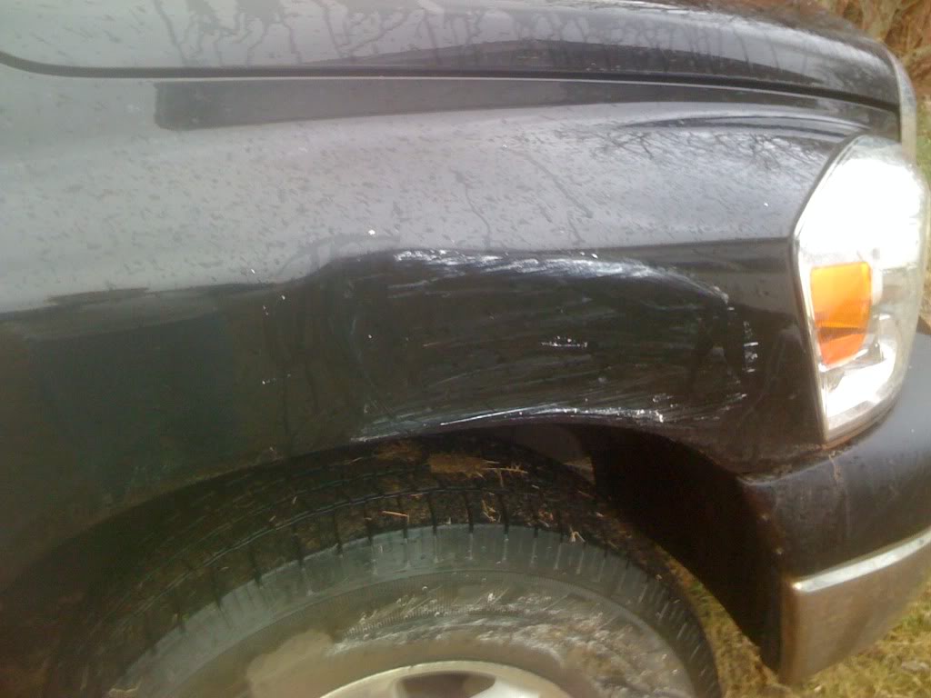

Well I got home today from doing some errands and quickly got out and grabbed the baby to get inside. I went out about 15 min later to find my truck resting against the side of the house. I forgot to set the e-brake and the truck was only partially in gear. Well with 40 mph winds it moved it.

It sucks. Im pretty ticked at myself but Ill see how much it'll cost to fix.

Get the wheel well cover off the inside and pop that summbiotch out quickly, it'll go and the sooner you'll do it the better.
Then you'll only have the scratches to contend with and I'd bet the majority of those will buff out with some compound...

ya, most of that paint actually wiped off. tomorrow Im goin to my parents for christmas so Ill take care of it then.
