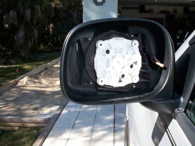

Anyone taken apart a side mirror? Or have a exploded pic showing how it goes together? Some little ***** in my neighborhood either cannot aim his bb gun or is just a vandal. Woke up this morn to a cracked mirror. I stopped by the dealer on the way home and they had one for $50. It's the defrost on the black plastic backing. Looked like it had a loop on top and a hook on the bottom. I've seen the mirror comes off from the inside, but how do I disassemble it to swap out the lense.

http://www.muthco.com/techsupport/pdfs/21000910.pdf
page 5 and 6 I believe is what you are lookin for. and for some reason, if this does not work, click below and just click your ram model year. that sould tell you in there.
http://www.muthco.com/techsupport/manuals.htm
You're lucky, I just found this late last night. Hope it helps ya out!

Thanks Moose, exactly what I needed

So I opted for the factory mirror, instead of the entire assem from china. I popped the old mirror off and installed the new one. Took a couple pics just in case you guys wanted to see what you're dealing with. Seems the mirror slides down and locks on the 4 posts on the mirror motor.
Back of old mirror
behind the glass..
