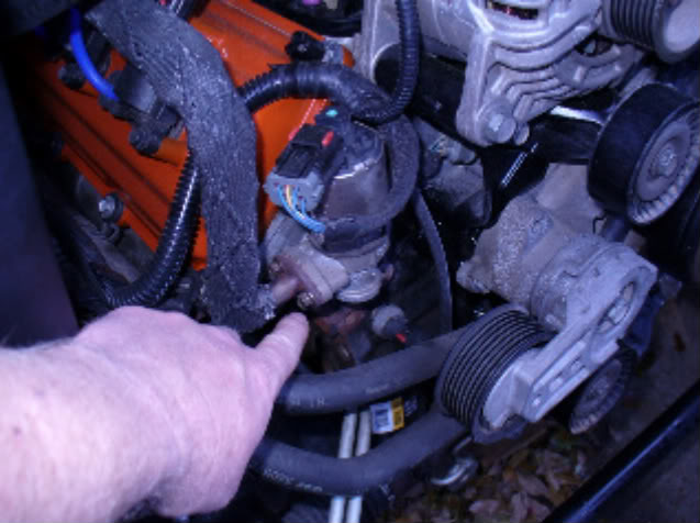

you can make the job much easier by removing the two 12mm bolts and one clip that bolt the brake booster to the firewall. It can then be GENTLY moved out of the way without removing the master cylinder or brake lines. Access these two bolts from inside the cab, and under the dash. I use an air ratchet, 8 inch extension and a swivel socket, takes me about two minutes to move the brake booster. There are two 8mm bolts and one clip to remove the egr line that runs over the passengers valve cover as well. this makes accessing the passengers coil packs easier. just be careful with the gasket, as long as you dont tear it, it is reuseable several times.
