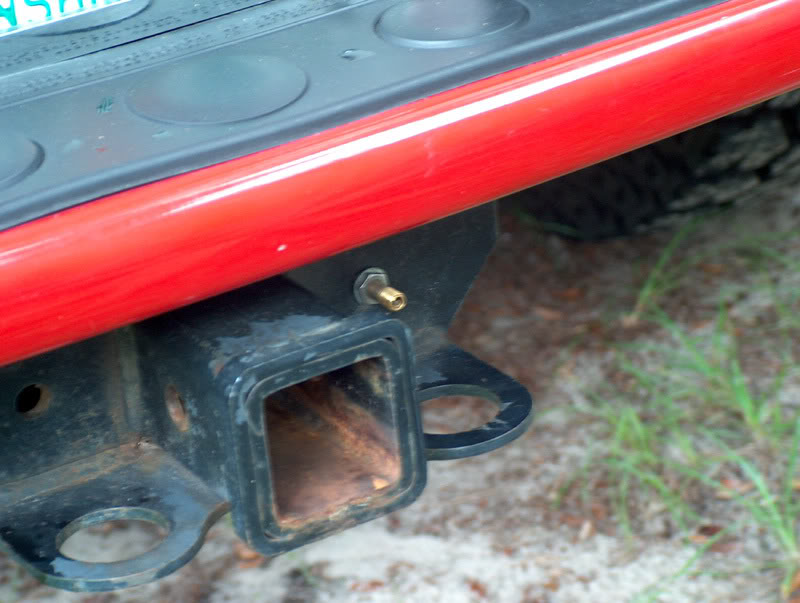

I was always kinda intrigued by this wireless setup:
http://www.airliftcompany.com/WirelessAIR.html
Course, I don't use mine often enough to justify an on-board compressor, I just use the poor man's method...

Originally Posted by kx250frider617
where did you get the fitting to run a T in the air lines. I hate trying to equalize both sides.
Came in the Air Lift kit. Had everything I needed to run a manual fill system...
