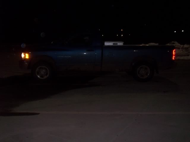

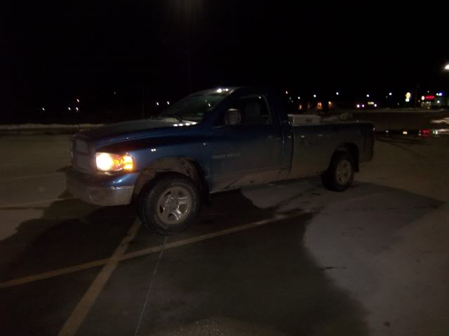

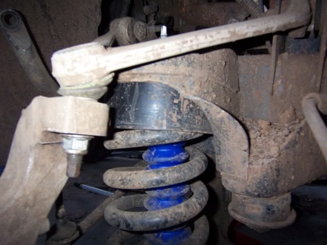

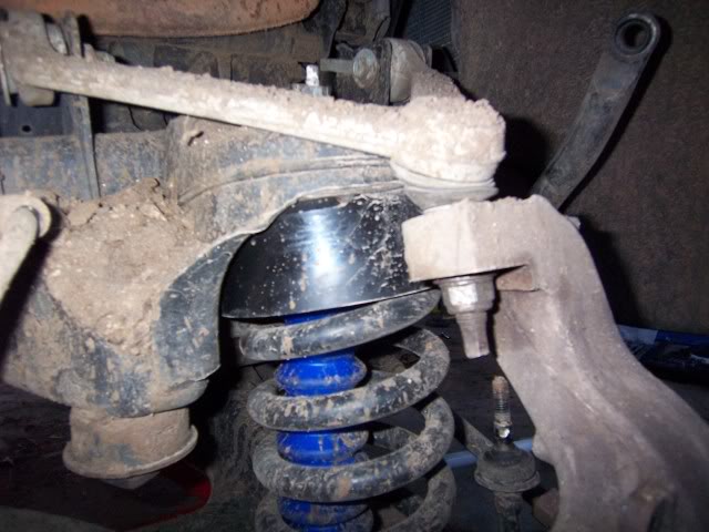

Anyone who saw my last thread about my level install knows it didn't go very smoothly. I saw that the coil isolator was not required with this spacer and what a difference that made! After the original install I was sittin at 8.5" in the front from tire to fender and 7.5" in the rear. I removed the isolator today and managed to bring the front down another .75" still a quarter inch high up front but it isn't very noticeable. Heres some pics of the difference with isolator and without.
With

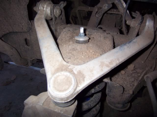

Quite a difference, and after removing that the upper control arm issue of hitting the spring bucket isn't near as bad.

I just got done so it's kinda dark, but heres some pics I took out in the Walmart parking lot in my quest for light.

So to anyone who has purchased or is planning on buying the Fat Bob's 2" kit with Procrap shocks I suggest leaving off the isolator and hopefully it will work out for ya. Mine might still settle a little more but idk, I definitely need an alignment though!
