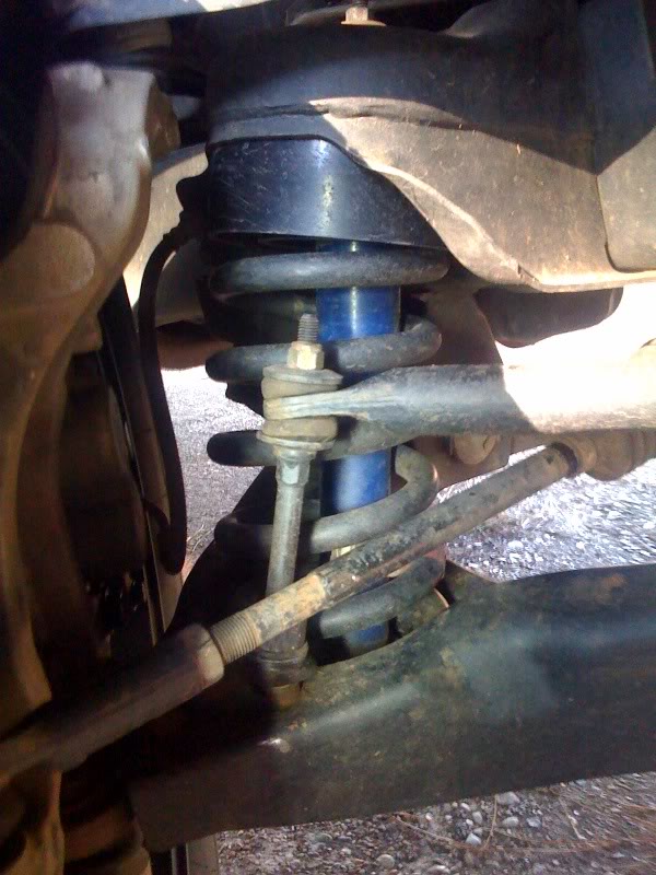

Mine worked with a BFH really hard on that little outcrop beside where the balljoint goes in. It will dent a little bit hitting it. In the top left hand corner of the pic, you can see where I beat the hell out of it on the spindle
