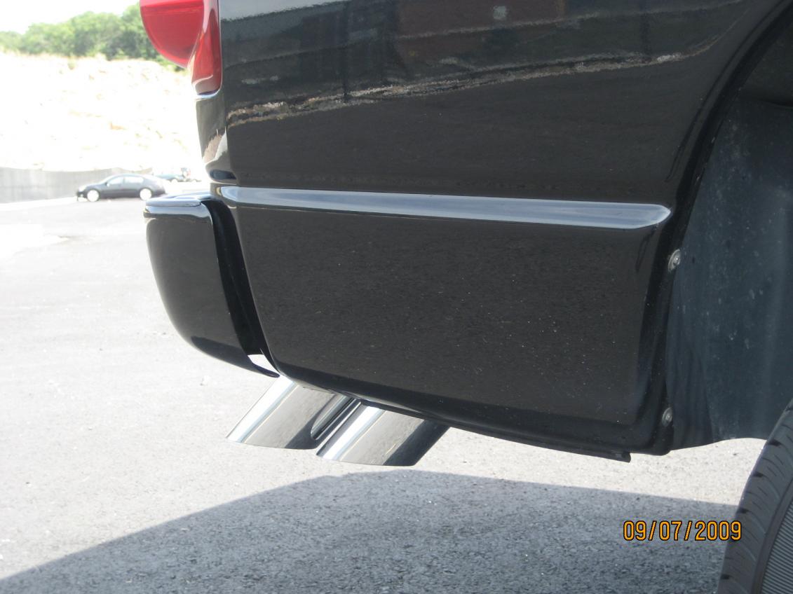

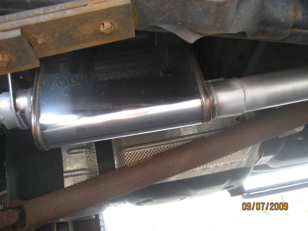

I own a 2007 Ram 1500 - Reg cab- Sport- 4x4 - 5.7 liter Hemi
include a K&N FIPK CIA with 2.5" pipe off cat to new MagnaFlow Muffler, single exit to Dual 3" tips..... No other performance mods ONLY 27,000 miles
I have been having trouble with the vehicle shaking at highway speeds. The Ram was brought into dealer with 22500 miles and was diagnosed for all stock Goodyear Wrangler tires being defective or damaged because they warped off the radial causing the shake. I had Goodyear replace 3 tires for free and I paid for 1. Replaced with Goodyear Wrangler -Silent Armor- in stock size... also had the transfer case replaced that same time.
Upon initial replacement I still felt the shake but wanted to wear the tires in. 4000 miles later i noticed bad wear on the front left edge. Brought back into the dealer, they rotated drive shaft and replaced front left tie rods. Got the truck back the steering wheel and truck still shake at highway speeds still.......
Brought it back again, and the entire drive shaft and steering shaft were replaced. the steering wheel is much better at highway speeds but i still feel shake during accel. and decel. on the highway.
NO IDEA..... looking more into these Dodge forums i feel like i may have brought this problem on myself. is it the after market exhaust and the MDS that makes my vehicle shake? It does feel at times like the shake is a feedback from the back pressure of the exhaust.......
ANY help is appreciated
Attached Thumbnails Ram Shakes @ times, 60+ mph, NO Idea.. Magnaflow Exhuast-img_3557.jpg   Ram Shakes @ times, 60+ mph, NO Idea.. Magnaflow Exhuast-img_3564.jpg
