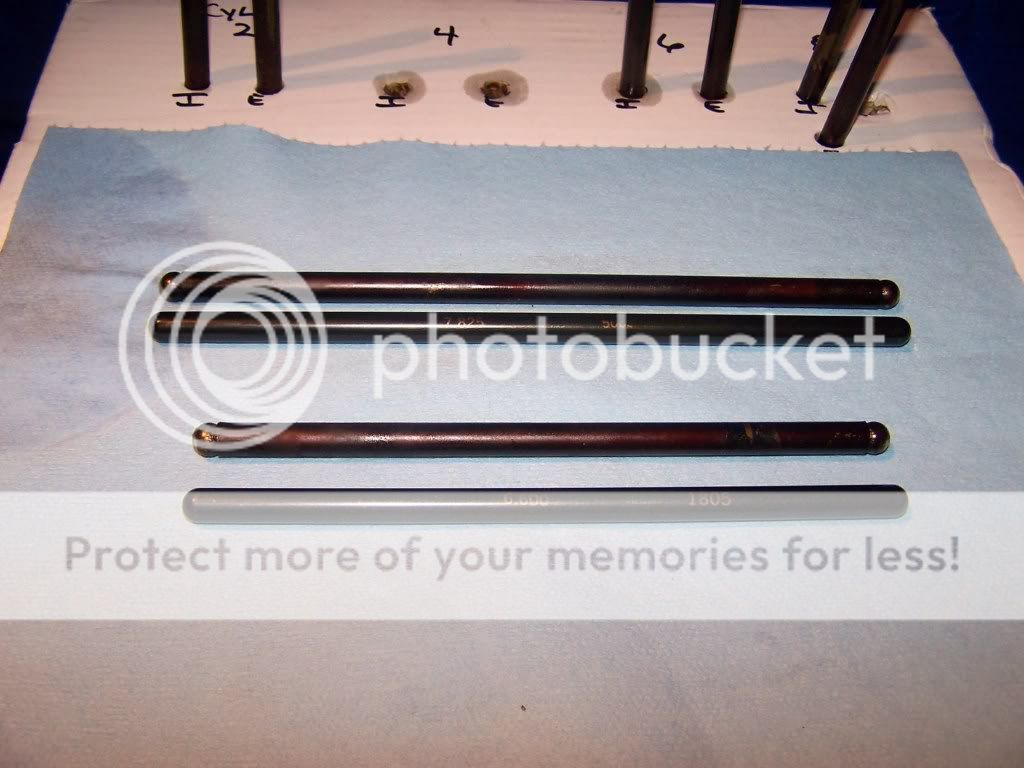

Originally Posted by oneHEMI57
FireFighter, would you mind posting a couple of pics just for everyone's FYI of the 5.7,6.1 int pushrods w/a bic pen and 5.7, 6.1 ext pushrods w/a bic pen. so we all can get a gander of the rods sizes to pen size?
oneHEMI: I am so sorry, I forgot all about your request. I took the pic's for you (minus the Bic pen). The old and new rods are lying on a standard shop towel, so you can get an idea of their size. I hope this helps and again, sorry for the delay.
