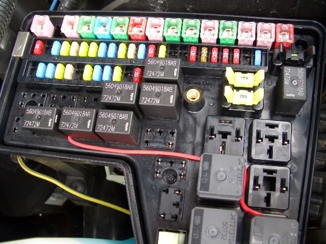

Im looking for a possibility to use the FogLights & HighBeam at the same time...
for the older RAM i know there is a was with a cable to bridge al relais...
is there a way to do the same by a RAM from 2004?

Very easy to do on all models pre-'06:

Yesterday I tried that DIY Hammer posted but I wasnt able to get them to work still. Could have been a bad connection I suppose. But ever since trying it, my lights will no longer flash when I lock or unlock the doors. Maybe one of those blocks shorted? I dunno. My blinkers and everything works fine still.

A few years ago I had my mechanic disconnnect the pog light harness and re-flash the computer to think that I did not have any fog lights. When I reconnected the fog lights I was then able to run both my fogs and headlight and/or high beams at the same time.

yeah, it's a simple setting with the StarScan at the dealer. They simply set your lights to "Canadian Mode". But the problem is, it's illegal here in the states, so you usually have to know someone at the dealership to get it done...

Short of the StarScan at the dealer, I've not heard of a fix for the '06+ trucks...
