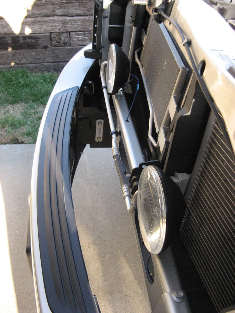

We had some great weather in Ft Worth today so I did some work on the Heavy Duty.

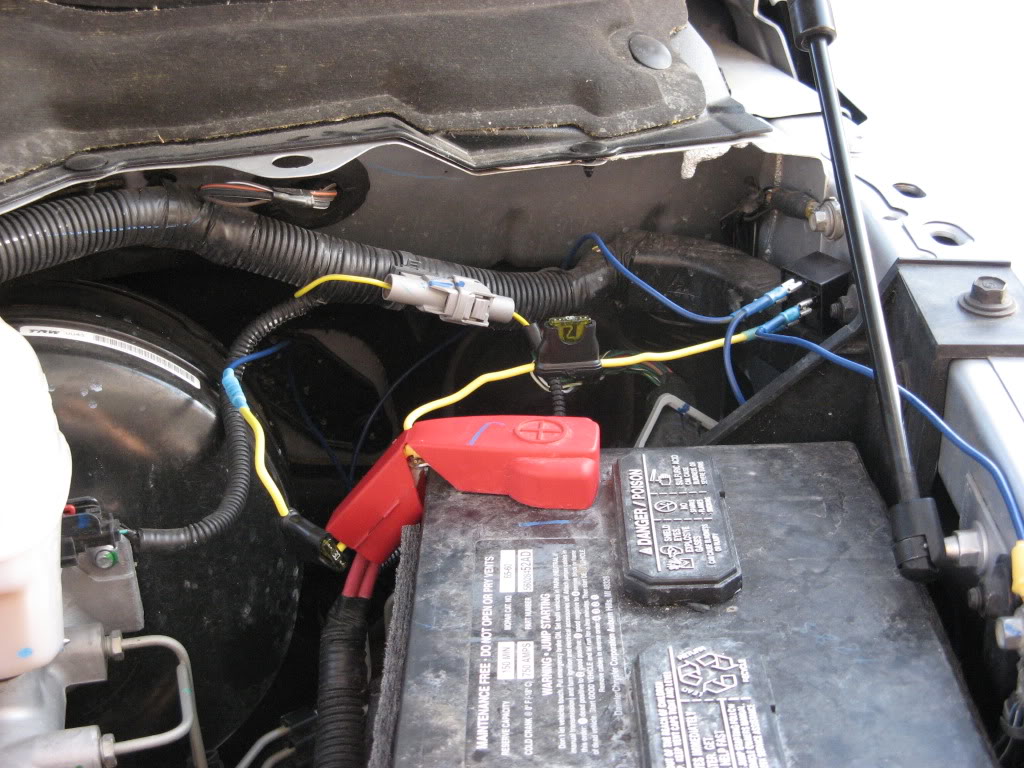

Changed out the factory Hella wiring harness to 14 ga. all around and added heavy duty inline fuse holders (30 amp). The relay is new as are the 100w bulbs. pretty staight forward just, time consuming. Used only one color on the wiring (blue) but the in-lines are yellow. Cleaned it up a bunch. Weatherproof connectors and heat shrink should make this bomb proof.. Please chime in if I should run a lower amp fuse.

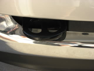

Got the factory hooks on CL for $50. Longest part was getting the plastic insert out with those PITA fasteners. Hooks bolted right up without dropping the bumper as the brackets were alrady there (but no hooks). Thinking about what to do with the void in the bumper, trim and reinstall insert or look for something else.

I am going to do my hella install and lids next week. I picked up a 30amp fuse in line also I figuerd the relay is 40 so I wanted the fuse close to that. Whats the guage looks sick

where did you ground your hellas to? just the support where they mount?

Bball,
Hard to see in first pic but just to the left of the light on the support beam. I tucked it up pretty close. Drill small pilot hole and finish with self tapper (tough metal)
