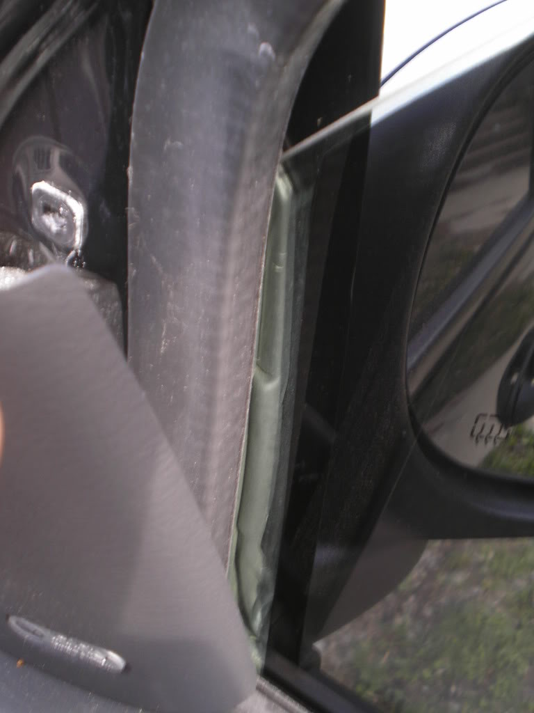

I know what your saying about taking the mirror off... if you dont, when you cut it on the outside, there will be a strip missing on the inside... got in a heated argument with the guy at the tint shop about this... i can take a pic if confused..

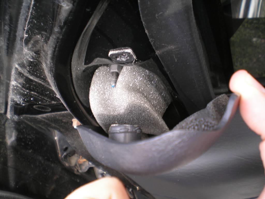

to take off the mirror, i think you just remove the single screw on the inside to remove that panel, then i think you'll see a few bolts.. should be the ones you need to remove

yea the mirror has three bolts, one in each mounting corner. Have to take the nuts off of those, 10mm I think. And to get the door off, do like blackedout said (uses a torx driver)

heres a pic behind the panel in the interior... i think you just remove the nuts... not 100% sure thou.. ive never done it.

then here a pic of where you can see the tint is cut short... its not real noticeable until its sunny out and then its pretty obvious.. im kinda **** so it really bugs me
