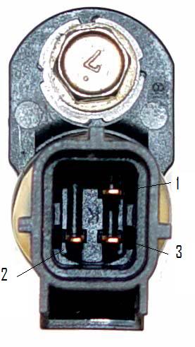

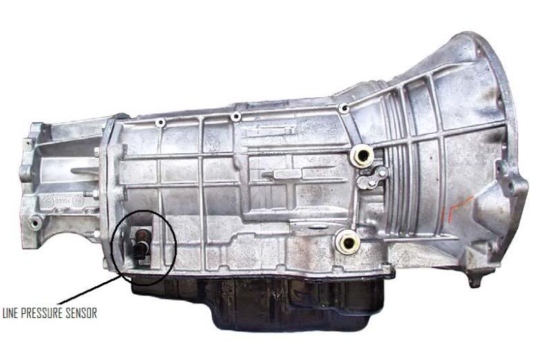

if you open it up, they are not made very well. they didnt even solder the wire connections, and half *** crimped them. the resistor in mine fell out. this is totally different from the resistor mod though. the resistor mod uses a 2.2k ohm resistor that connects wires 1 and 3, and the sonnax uses a 15 ohm on wire 2. wires shown on pic below. the sealed weatherproof connectors are very nice though.
