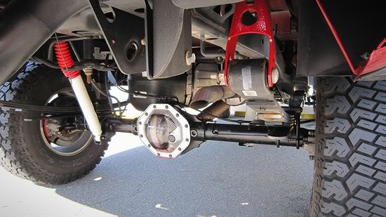

Forget blocks, those are ghey. Order a set of drop shackles from a 2g ram. They work as lift shackles for the 3g. You can get them as cheap as blocks on ebay.

Originally Posted by weedahoe
^^^^^ Whose truck is that with the clear pumpking cover??
That's my truck. The only problem with the cover is that a spider got in there and made a web!
Originally Posted by Mega-Hemi
Damn Frog, were you standing up when you took that pic?? lol.. Where's the elevator to get in that thing?
Nah, I'm a midget. For real.
Originally Posted by 98cherryram
How much do those shackles lift it? I never knew that until you showed me that. Now I am thinking about doing that!! lol.
The lift is equal to half the difference in length. If the shackle is 3" longer than stock, you get 1.5" of lift. It's a geometry thing.
