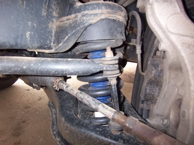

Heres at full lock with the full weight on it, the angles aren't near as bad but that spacer makes me nervous.

dammm your tire is way to close to the a-arm . you need spacers bad!!!!

What size spacer is that? What ever it is it is too big and causing the issue. Are you using OEM spindles or lift spindles? If OEM them get lift spindles and lose the spacers.

the spacers are causing all the issue , you need new spindls
