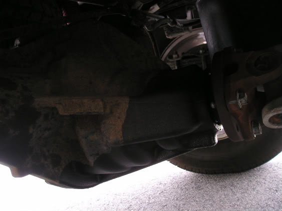

So I've had nothing but a gear whine since my 4wheelparts (Santa Ana[LOST my business and all I mention to]) gear install. When I had my friends Mechanic help me with my first rear diff oil swap we noticed their mickey mouse china oil they used as break in oil. A nice layer of glittery oil at the bottom but luckily no metal chunks. And when I swapped my shocks out to the RS9000XL's I've had sitting around for too long I noticed my housing looking a little like this, any thoughts ? Crush Sleeve?
Sorry for the read, here's the pic's:

Very very slow leak as you can see by the bead of oil at the bottom of the diff.

rear pinion seal. not too bad of a fix. some people say that overfillin the pumpkin will cause this. drop the driveshaft, take off the nut than pull the seal out. when puttin in the new one try to knock it in even, with a 2x4 layin across it or something. dont wanna get it in a bind

yup, pinion seal. But let it go to long and it will ruin your inner seal and then your gears will be shot. Just happened to me however I had a good experience with 4 wheel parts and they replaced the gears themselves for free just had to pay labor and $14 for the seal.

The sparklies are normal for break-in, but I don't know why they didnt change that seal when they did the gear install??? Did you not have them do all the bearings while they were in there?
I'm sure you already know, but there should be no whine with gears, if anything....so mild you would have to make it make noise.
