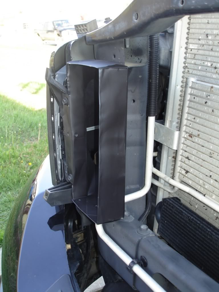

Here u go took me about 45 minutes to make it out of a 5' 4x10 galvanized
right angle boot paid $7.55 canadian for it at home depot!
id advise to use leather gloves since tin can slice u up like a razor blade
after i was done i just used some duplicolor black sandable greycoat to hid it a little now keep in mind i did this fairly quickly and im gonn actually but some decent sheet metel and do it the correct way this was a trial run and worked out pretty good i just need to trim top back a little hitting grill gaurd bar...
