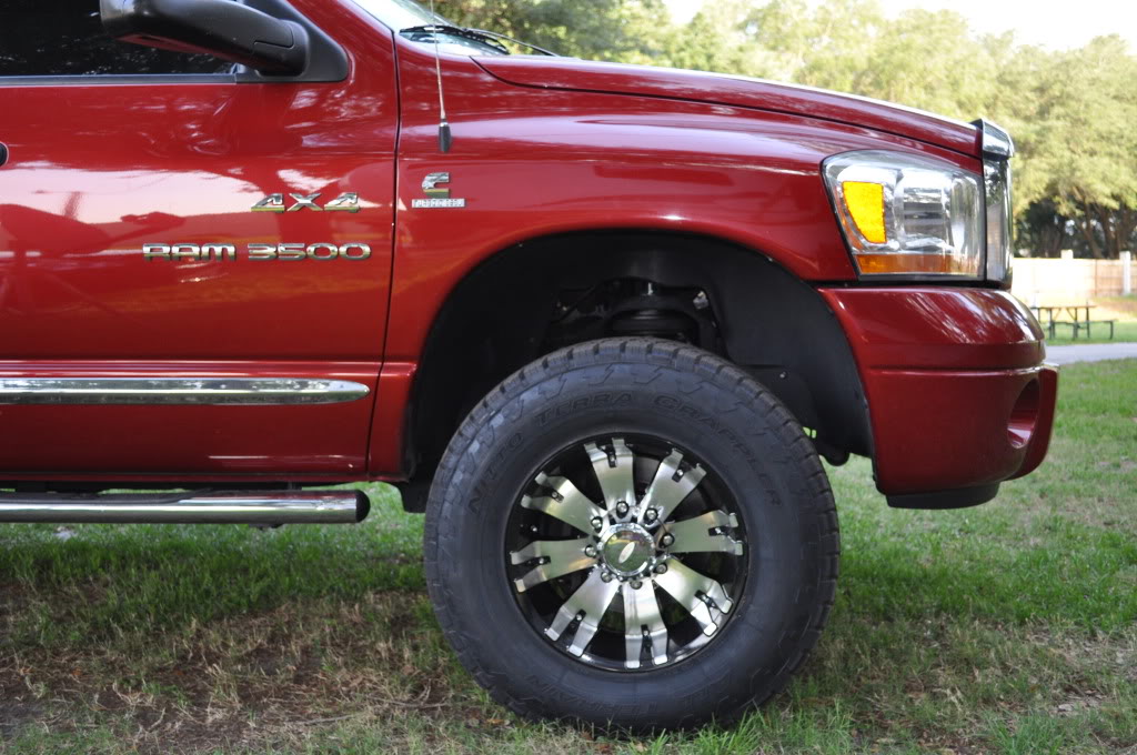

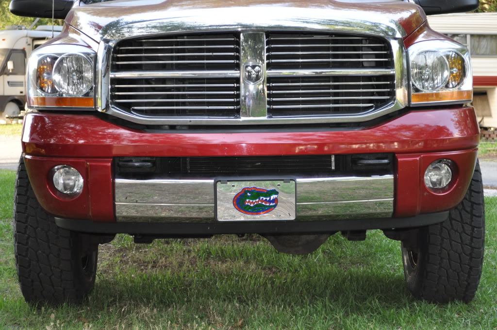

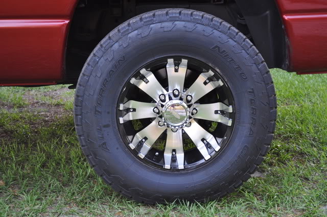

I can't answer a lot of your questions, but I can say that 35's look good on Megas...here's a few pics of my mega with them. I have a 2" Hell Bent Steel leveling kit on the front and only have a slight, intermittent rub when turning. I wanted 37's but they are not practical for me as I have a 14k lb 5th wheel RV I pull. For 37's to fit, I believe you need at least 3" to 4" of lift. Ramhunter9 has 37's on his 2500 Mega 4X4 and I think he has a 3" lift.

Here's a couple pics of mine for reference on the 35's.
