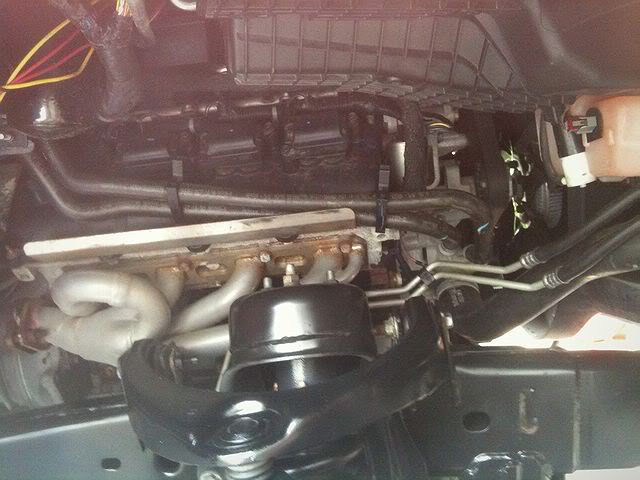

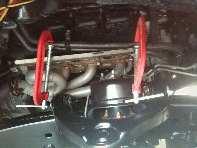

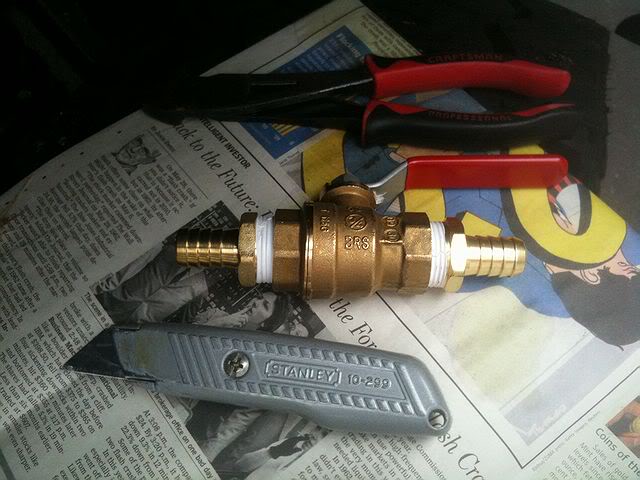

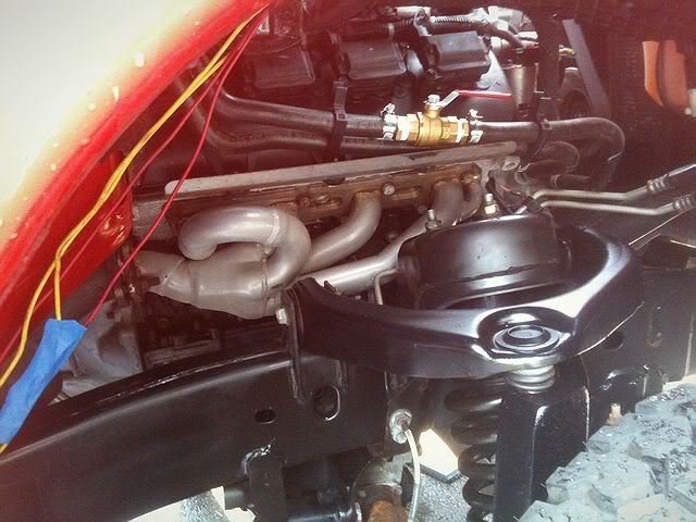

Here are a few pics and tips for anyone looking to do it. Use the top hose so it's easier to reach the valve when you need to change it. The hoses are 5/8". Don't try to use 3/4" barbs as they're too big and they'll leak. Also, watch the tails of your clamps so they're not rubbing the bottom hose or the valve cover. Use a 5/8" or 3/4" valve, any smaller and you'll restrict flow thru your heater core when you want to use it (less heat in the winter!). After clamping the hose, cut out a section of hose slightly shorter than the body of the valve (not including barbs). If you don't, the hose will be too long and the valve will hang to the side all funky.
