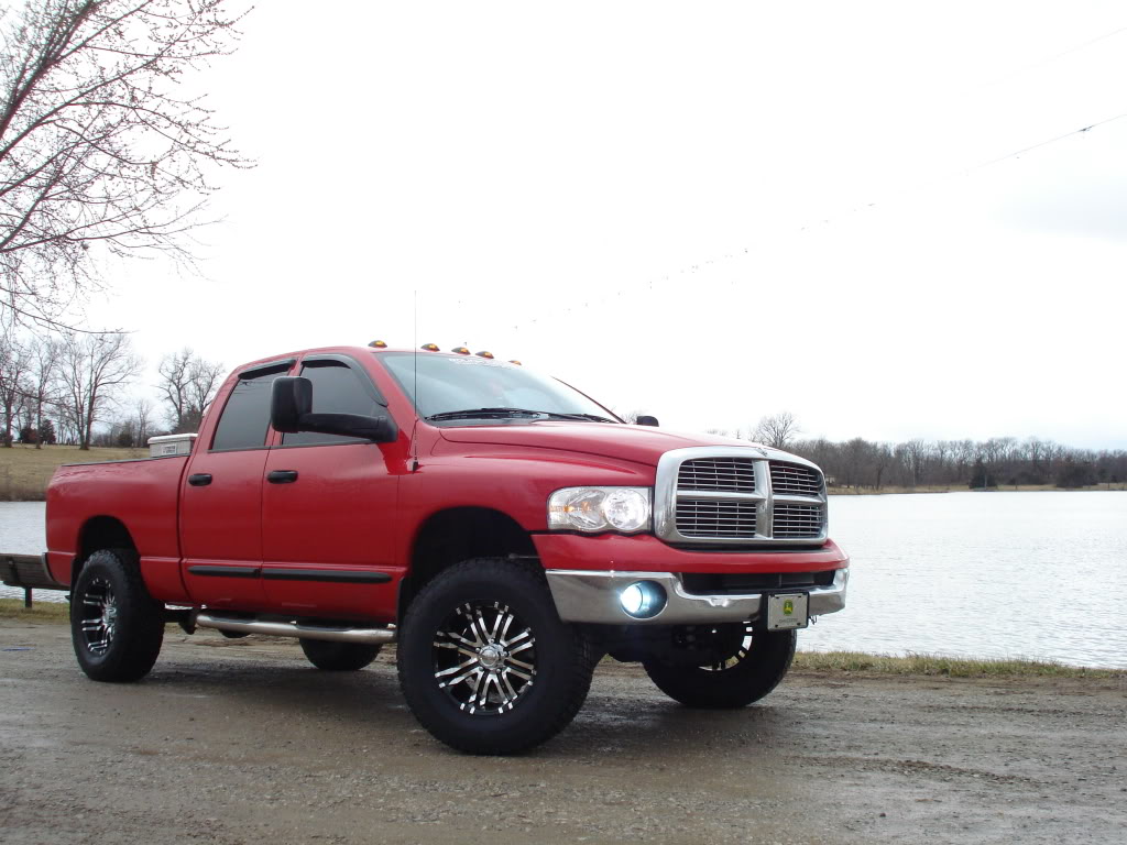

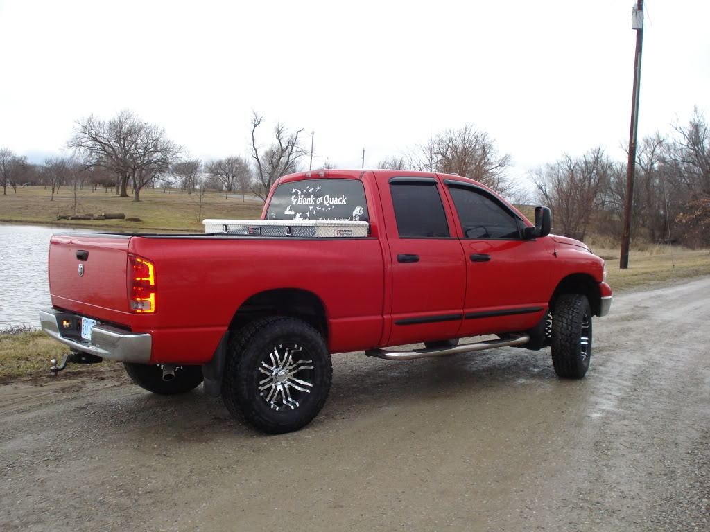

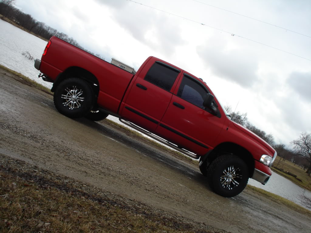

here is a RC 6 inch lift with 34's

So if I get the 4" spindle kit from suspenionmax will it come with everythin I need for the front and back and will I be able to put 35's on it?
