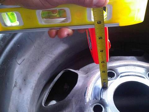

I'm so wrong. Looks like I'm about an inch off on the backspacing. 5.5" of backspacing if you can't see the picture.

Right, that inch of backspacing say going with a 4.5" backspaced rim will "push" the tire out from the suspension components. Mostly the uca. Then you will have no more rubbing.

JMaxx, you and I have the same model, same rims. I just got the rc 3" and the kit says stock rims should have 4.5 backspacing or aftermarket rim required. You can find the spacers with extended studs but I've heard it is not the thing to do...
I want bigger tires but don't want rubbing and I can't afford new rims.
