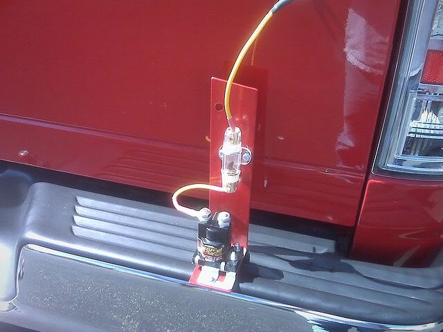

It's not just the fuse you need to worry about, those small bosch relays burn also. Here's what I ran with my efan (I've had a mark viii and a viper fan. Never a problem with either.

Frog,
WOW That certainly looks stout enough...
