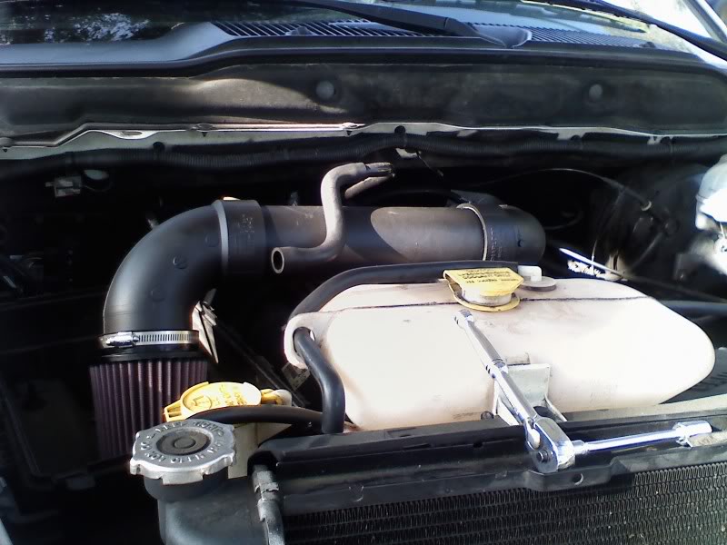

Here is a shot of mine. It's 3" pvc with a K&N cone filter on it.

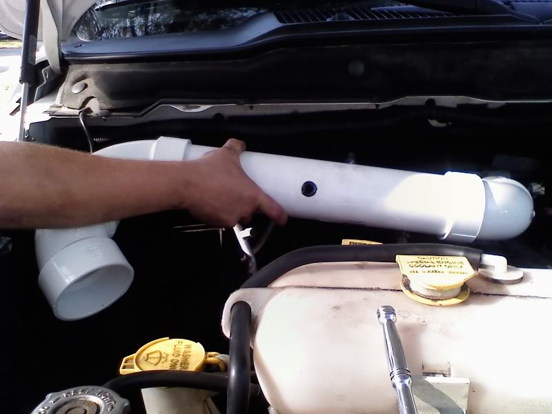

A couple I have made or have walked guys through making over the last couple of months:
This one is CwboyJohnny's just prior to unstalling the "baby filter" on the CVT:
Cost on these was right around $60-65 WITH a K&N Cone filter, with a no-name filter such as a Spectre you could shave the cost by about $15 or so...

Do I need to make a hole cut out for any sensor or sensors to be put in? What about the heat shield? I see some with and without...?

We just installed the filter so it rested in the lower part of the factory air box where the filter normally sits. It gets air from all around including where the factory has the air drawn from the front of the truck. You can see in my pic above. Also, here is where the air sensor is. I forgot how big a hole to drill but you just drill it and find a grommet the same size as the sensor and push it in.
cai6.jpg?t=1277324126
cai3.jpg?t=1277324273
Old Jun 23, 2010 | 04:45 PM
Skillful's Avatar
Skillful
Joined: Jun 2010
Posts: 26
So just 1 hole is needed?
Old Jun 23, 2010 | 04:48 PM
cwboyjohnny24's Avatar
cwboyjohnny24
Joined: Nov 2009
Posts: 1,886
From: Orlando, Fl
yep. You can see the sensor on the firewall side of the tube.
