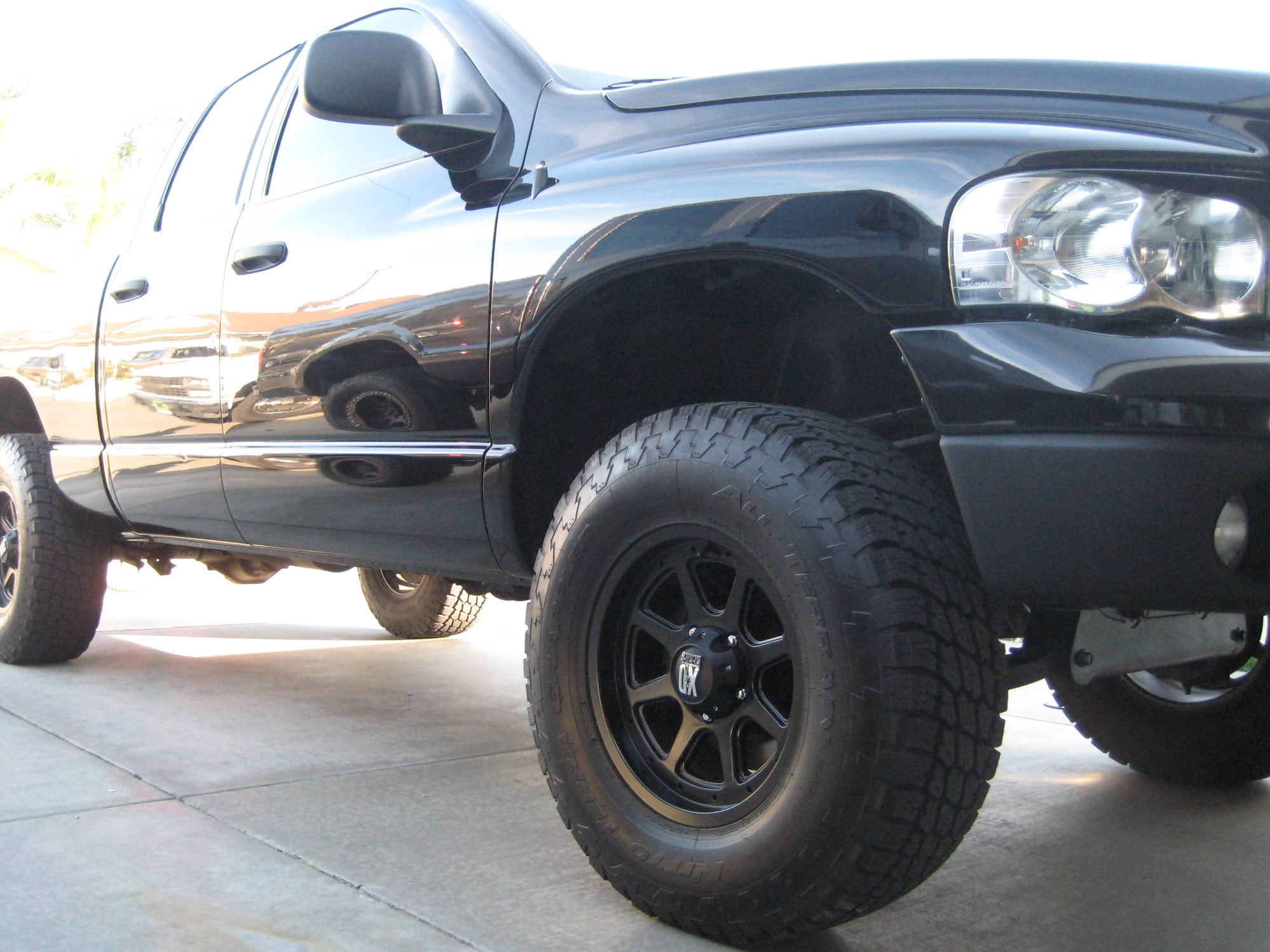

I cranked my bars and fit 305/70/17 nitto terra grapplers, check out my newest pics. Fills the wheels wells perfect
