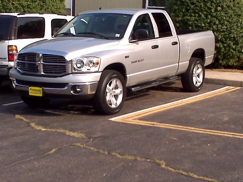

Thats about it...Thanks guys! Oh...I used to be on corvetteforum and those guys looooved pics...so figured I'd throw 1 up here I took off my phone hehe
